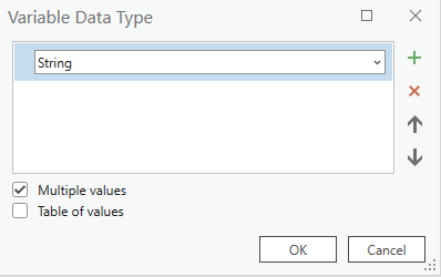

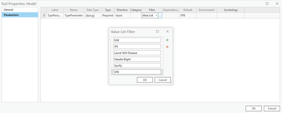

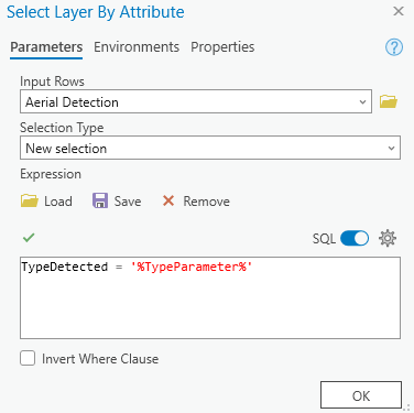

I'm using a ModelBuilder to select Multiple values from a layer and it is not working. It only works when I select a single value. What am I doing wrong please.
Model:
Select Layer By Attribute expression window:
Parameter:
Geoprocessing:
In the window below marked in red, if I only put one value (SPB) then it will select, however if I put multiple values (SPB, EAB, etc.) as shown below it will not select.
I've added a variable to the model that would allow me to put Multiple values.
