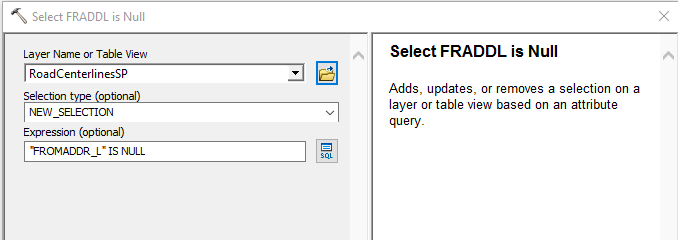

Sounds like you need to make a new selection. Make sure you have a feature layer (you may need to run the Make Feature Layer tool first). Then you can use the Select Layer by Attribute tool, and choose the Selection Type of New Selection. In the Expression box, you can filter which features you wish to select. Here is an example from a project I'm working on.

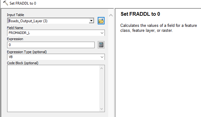

Then add the Calculate Field tool to your model and populate the Field Name you wish to make a calculation on, and fill out the Expression field.
