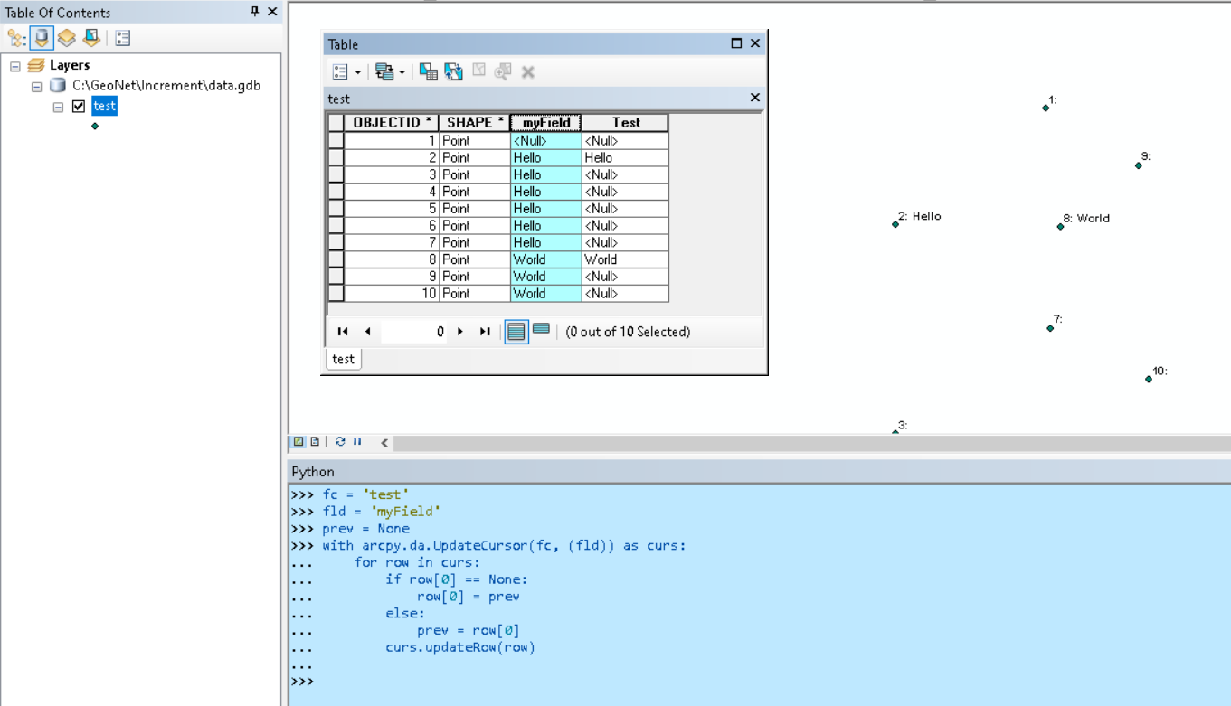

In the screenshot above you can see on the left of the screen that my featureclass is named "test", which is what I used on the first line of the code (lower center/right). My field is called "myField" (line 2 in code) and in the table you can see in field "Test" what the initial values were before running the script. Notice also that if the first record has no value, it will not be changed, since there is no initial value set. If you want to change this you can edit this on line 3 but doing something like:
prev = 'my initial value'
