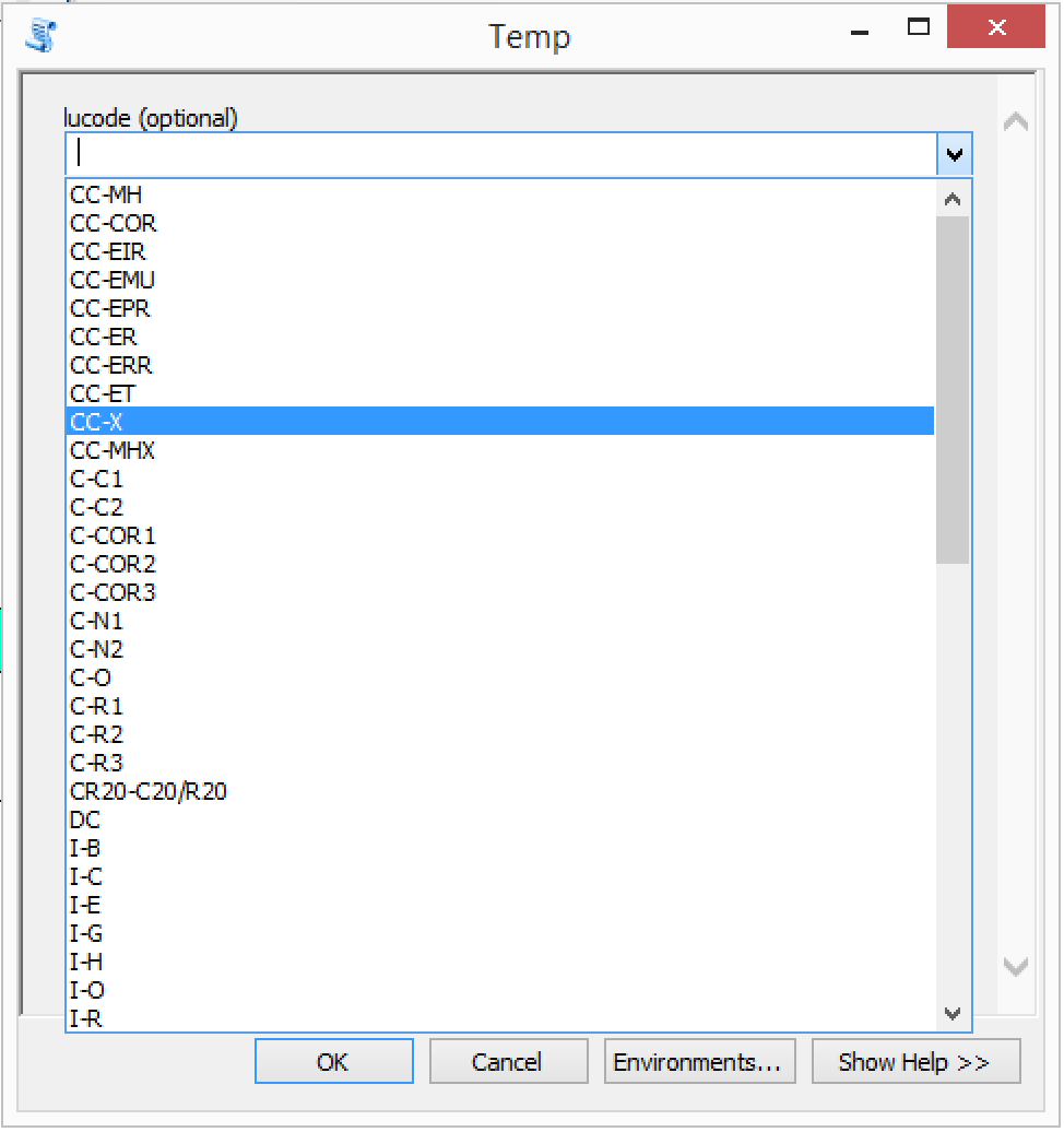

Hello,
I have a script tool that is quite simple. It's main purpose is in displaying the following drop down list, the script itself doesn't really do much.

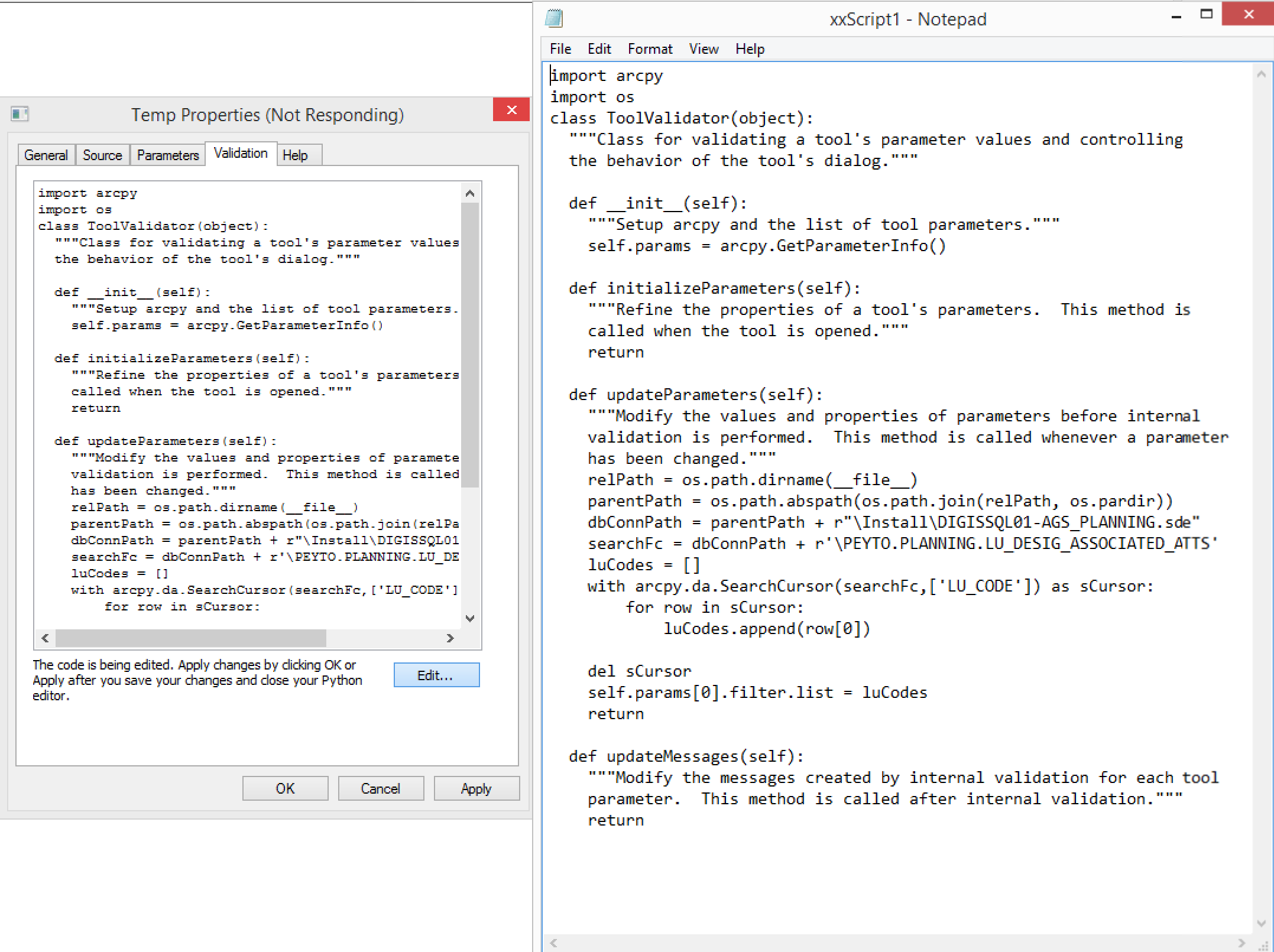

I am using the validation tab in the script tool to put the code to generate the items for the drop down list:
The script itself just displays the name of the selected lucode:
This all works fine on it's own as a script tool. But what I really want to do is to be able to use this list in modelbuilder and have it as a model parameter. As far as I can tell it seems as soon as I drag this script tool onto the modelbuilder interface, I lose the functionality that was available when it was run on it's own as a script tool.
Am I missing something? Is there a way I can get this drop down list displayed in modelbuilder and use it as a model parameter?

It's true that dynamic parameter validation is not possible in Model Builder.  My guess is doing that could make it even slower. 🙂
Another possible workaround is to create a script tool (with validation included) that imports your toolbox and runs your model tool. (Since export to script is not available in ArcGIS Pro this may be an easier option for Pro users.)
