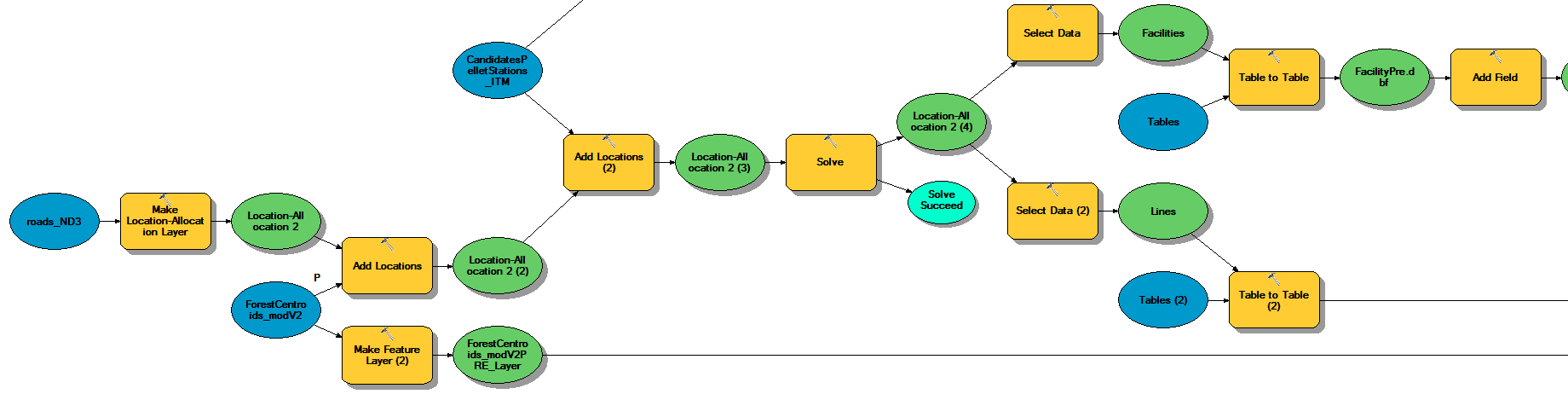

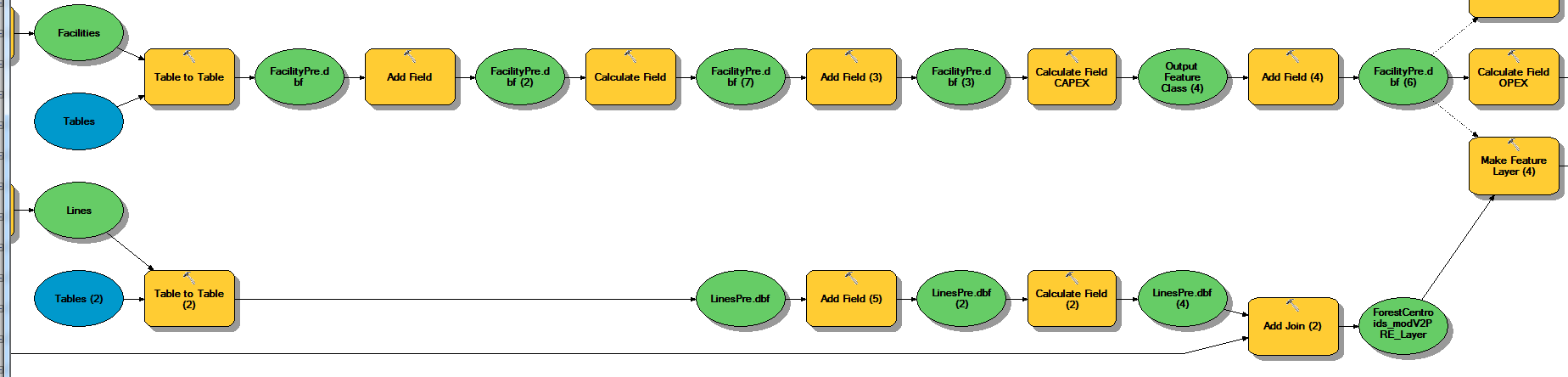

I'm using ArcMap10.3, in the Model builder. I'm experiencing a problem with the Feature Class to Feature Class tool. My model is actually a sub-model so it has one of the input changing at every iteration, identical fields but different rows. This is the part of the model (see the pictures).

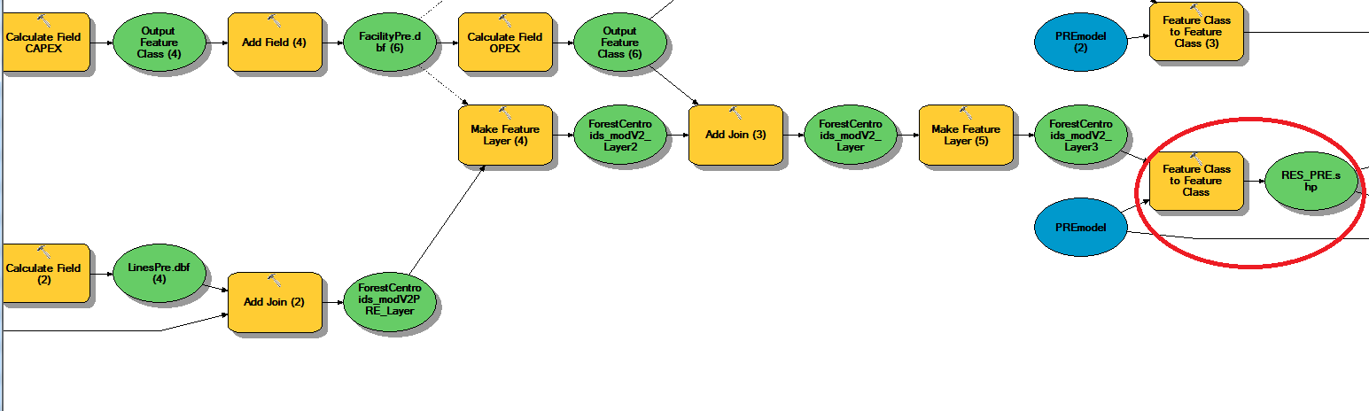

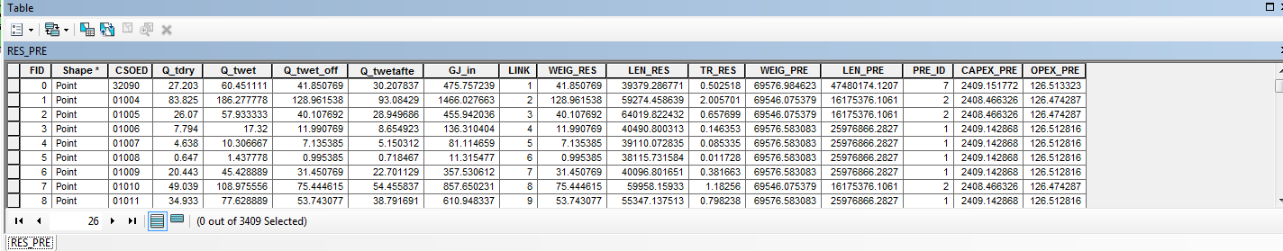

The problem is right at where the red circle is I guess. When I run the model with my default (or first) values ("ForestCentroid_modV2") everything is ok an this is the RES_PRE.shp

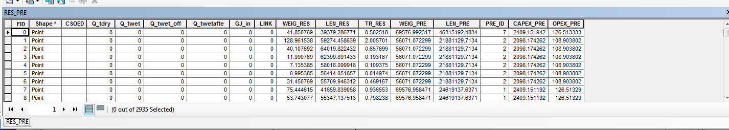

But, when I run the model with new inputs (same fields, same names, just different number of rows), I have all the fields coming from that input set to 0.

1. Delete the layer you had as input right after you use it by connecting it to a Delete tool with the output of Feature Class to Feature class as a precondition. It's possible deleting that layer will remove a conflict of multiple layers in memory with the same name. (A shortcoming of how Esri references layers by name only.)
2. More tricky, use the Calculate Value tool with a python function that uses the arcpy.FieldMappings() objects to generate a field map on each run. I have found this (although it is a bit of work) works better than letting ModelBuilder generate the field map automatically.
