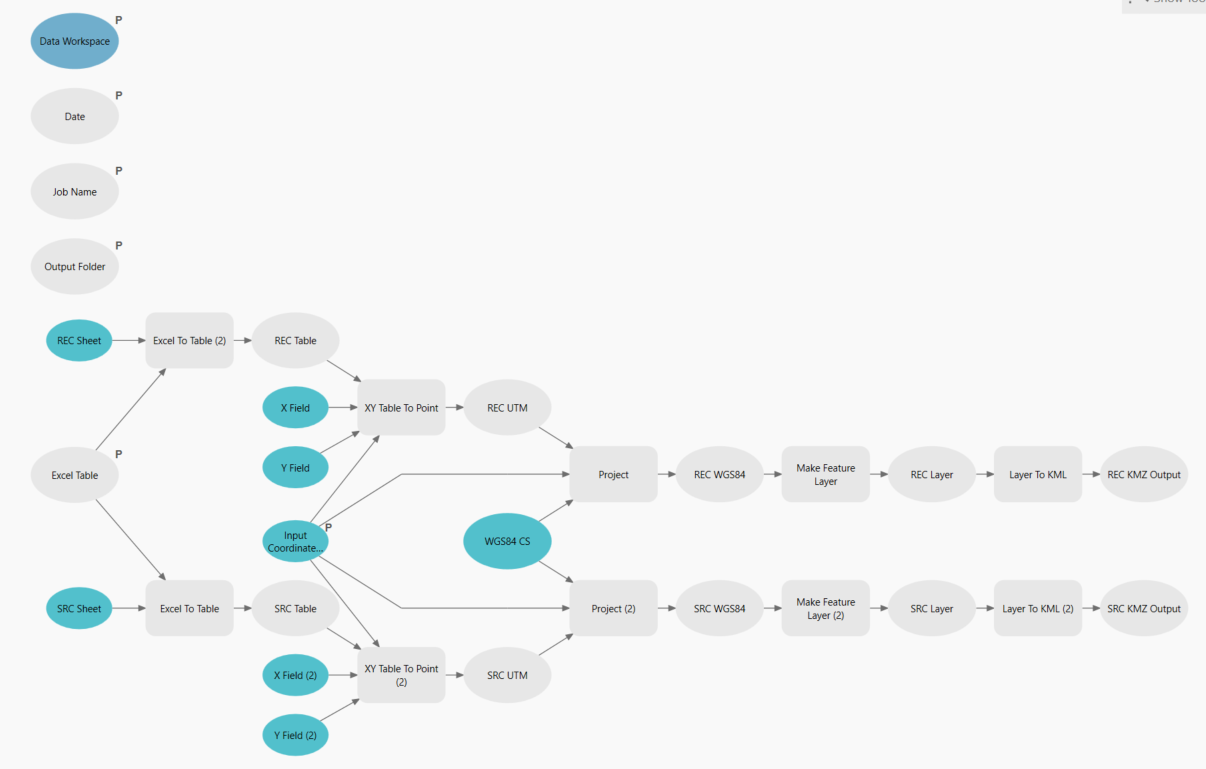

I am currently working within model builder and hoping to build a custom tool that others can use to run my process of converting a standardized excel table to KMZ.
My tool works fine but I am wondering how, if possible, can I add descriptions/information to the parameters in my model for potential users to read?
For example, I want the user to know when entering the date (string) that they need to enter it in YYYYMMDD format.
