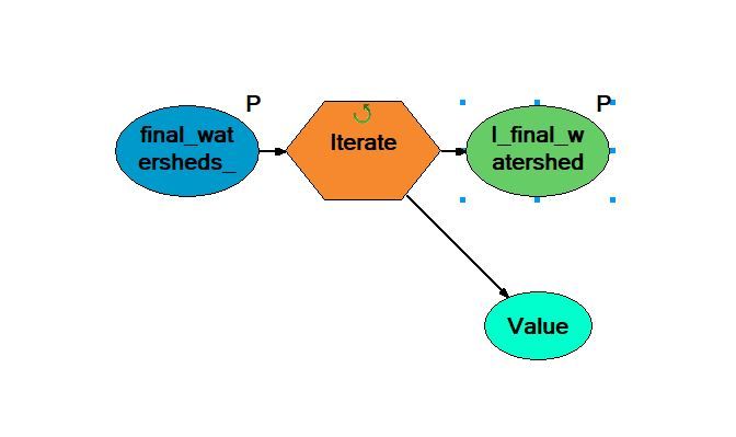

Hi all! I am facing a problem because I know is not possible to include 2 iterators in the same model builder. I have 10 features (polygons) in a shapefile and 1000 rasters in a folder. I want to calculate for each polygon the zonal statistical as a table for each raster. Therefore, I need to use:
  1. Iterate feature selection to avoid the problem of overlapping polygons and iterate each polygon
  2. Iterate raster to make the iteration of each raster in each polygon
Therefore, I need two iterators, any idea on how to overcome this problem?

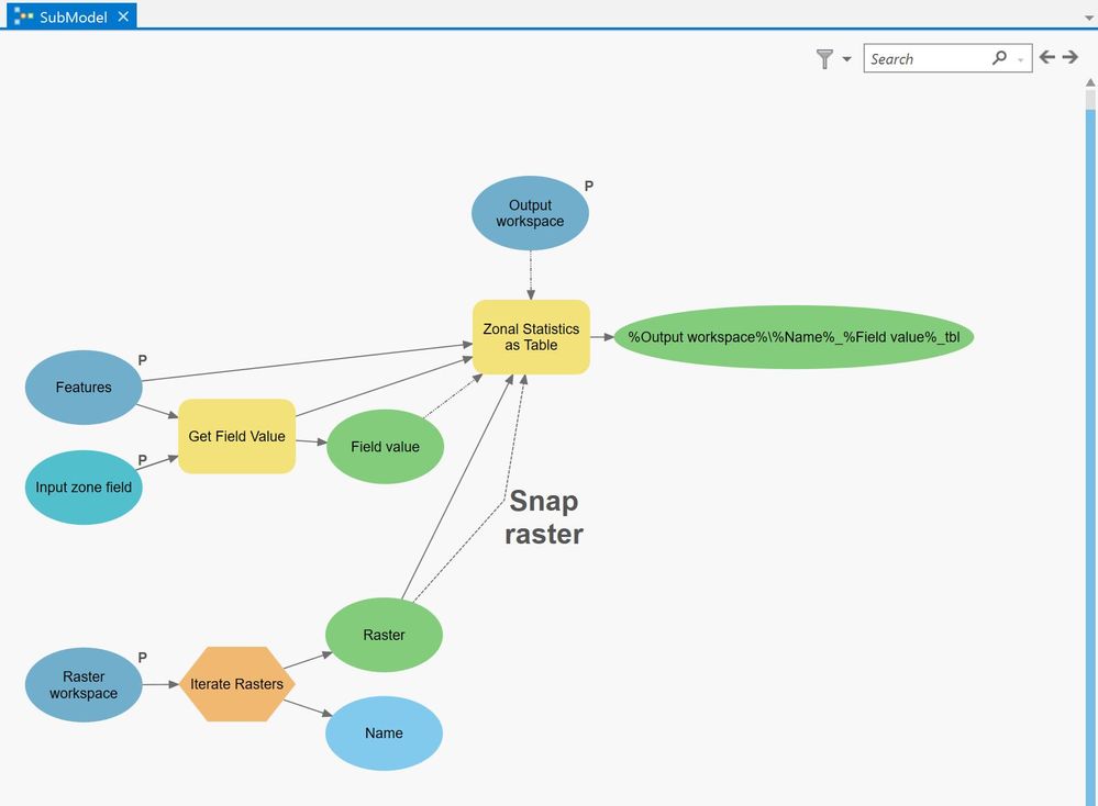

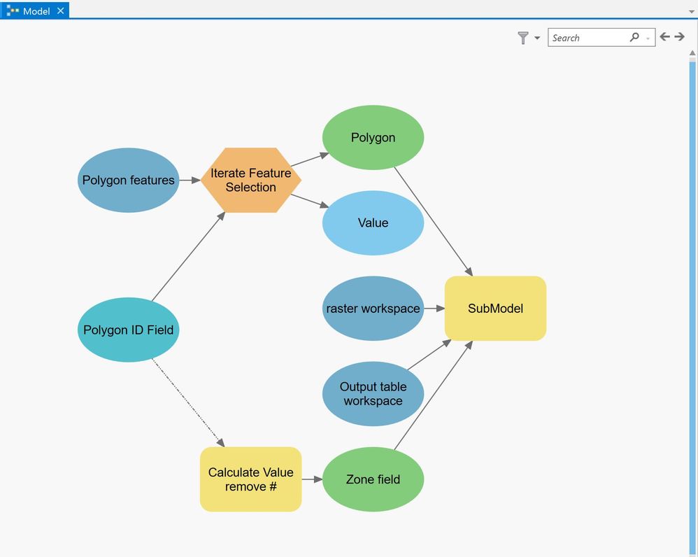

I am trying by creating a submodel and a model as shown in the images below but without too much success
Thank you!

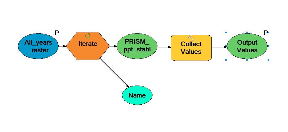

You are missing the Collect Values tool in your submodel, then the submodel will pass back the generated list of rasters.. See the help for an example. (UPDATED LINK)

I have changed the submodel as you said including the collect values tool. I have run it and seems to work fine.

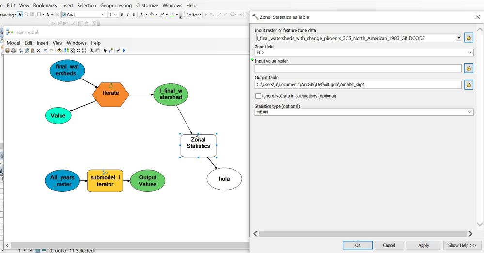

However, in the main model, I can not select the output of the submodel (Input value raster) in the zonal statistical as table
I still could not do it. I do not have license of ArcGis Pro!

1. You need to do the zonal statistics in the submodel. This example in the help (this is Pro but it applies to ArcMap too) shows this, the processing has to happen in the "inner loop", then each inner iteration set of results can be passed back up. You need to be careful to name your outputs uniquely using model variables so each zonalstats output table doesn't get overwritten, e.g. %shedname%_%rastername%_tbl.  It gets really complicated fast which is why we often use Python for complex iterations like this.

Just to prove it can be done, here is an example I worked up for the good of the thread.
(The Calculate Value tool in the main model was needed because the iterator generates "fieldname #" for the field name on each iteration, I cleaned it up with the Calculate Value expression %Polygon ID field%[-2:], output data type Field.)

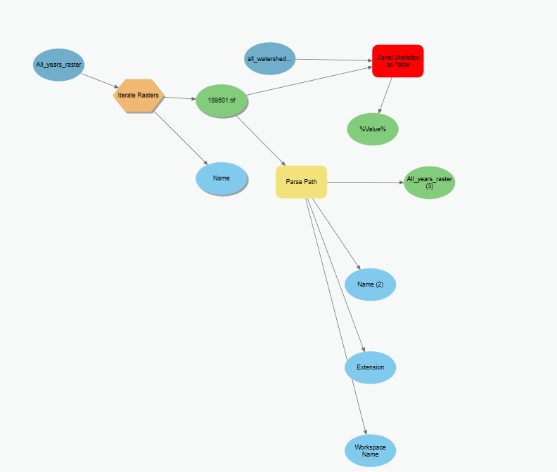

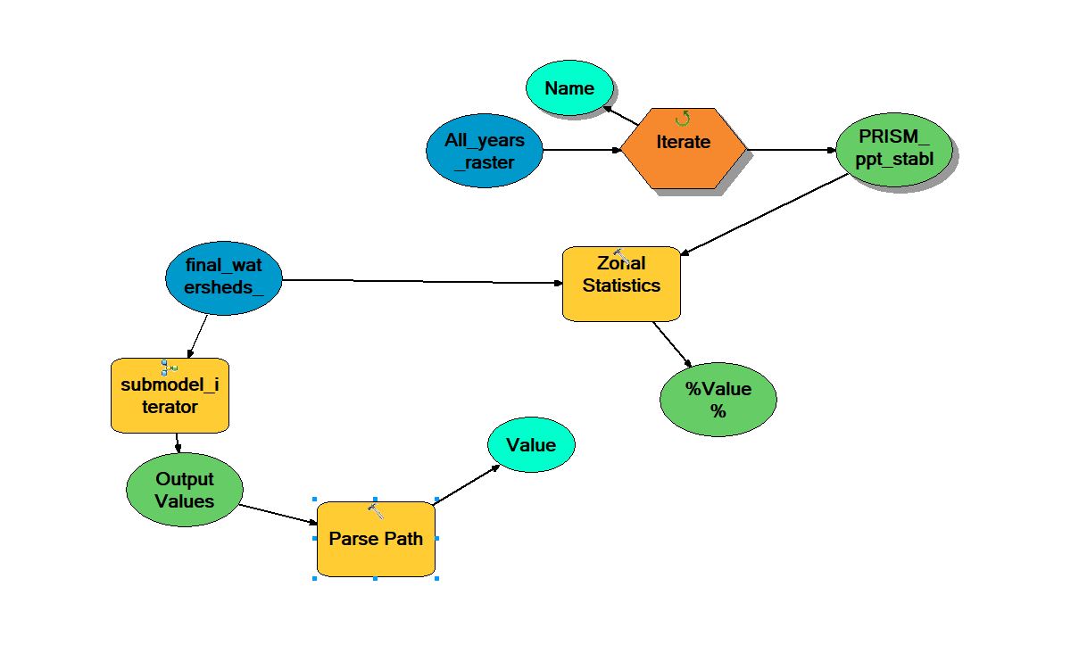

Hi, sorry for keeping asking, but I am having some problems to run it in ArcGIS Pro.
I am having issues to name the tables with the same name of my rasters because the extension TIF of the raster. I am using parse path, but I am not able to making it work in ArcGIS Pro. As far as I know, in ArcMap, you use %Value% to name the files once you extract the name without extension from parse path.
Also, when I am iterating over the  raster files, I do not got the symbol of the three arrows circling as I got in model builder of ArcMap.
Could you please help me to fix these issues?
I put an image of what I got until now in the model builder in ArcGIS pro.

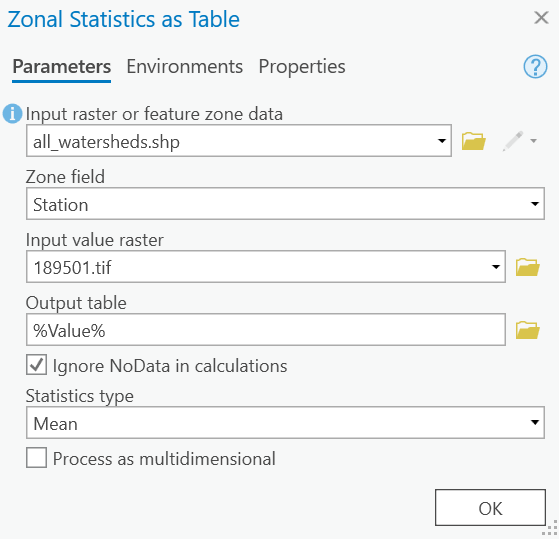

and this is how the zonal statistical as table looks...

The thing in percents is a model variable, not a default thing I think you think it is. I don't see a %Value% variable in your model anywhere. This won't work because there is no variable to substitute so it will use the text "%Value%" and %'s aren't allowed for items in the geodatabase. %Name (2)%_tbl may work for the output to your zonal statistics as table - though you want to connect the variable Name (2) to the Zonal Statistics As Table tool as a precondition to make sure the Parse Path runs first.
SAV
When I am trying to use %Name (2)%_tbl as a name, I have the following error %Name (2)%_tbl must not contain spaces.

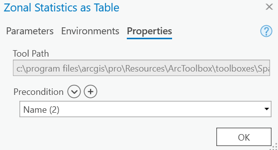

To do the precondition I have done the following in the Zonal Statistics as table
