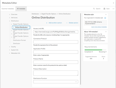

Aggregation (DS_Series, etc.): Series records: We had hoped that, when publishing a hosted feature service with many layers, ArcGIS Enterprise and/or ArcGIS Pro would be able to handle the hierarchy and reflect this in the metadata editing features. For example, by having feature layers inherit some of the feature service metadata, by producing a series metadata record for the hosted feature service that aggregates the layers as separate datasets. Are you able to point to some documentation as to how one can accomplish this using the platform?
I am not sure if I am fully understanding the ask. This may require further back and forth. What initially comes to mind is the Online Distribution section. If you can, please provide additional context.
Distribution linkages: When importing ISO metadata via ArcGIS Pro or Portal, the online distribution information (mdb:distributionInfo/mrd:MD_Distribution/mrd:transferOptions/mrd:MD_DigitalTransferOptions/mrd:online) does not appear to be imported or exported by the metadata editor on either ArcGIS Pro or Enterprise.
As long as the metadata element is present in ArcGIS Metadata XML, metadata elements should not be dropped when importing metadata into ArcGIS Pro/overwriting metadata in ArcGIS Online/ArcGIS Enterprise. If you have not done so already, I would recommend contacting Esri technical support to investigate the issue further.
