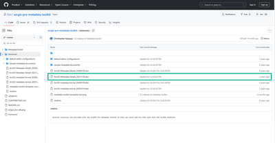

You can access a spreadsheet that documents the metadata elements in the ArcGIS Metadata XML on ArcGIS Pro Metadata Editor Toolkit on GitHub. The latest version available is from 2021, and any updates or changes will be clearly indicated on the repository.
