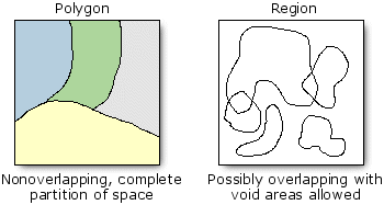

ArcInfo did support overlapping polygons in coverages - they were called regions. There is some good background info on this page: Overlapping polygons in a coverage: Regions There were downsides to polygon coverages as well, you couldn't have multipart shapes or voids for example.
You can probably blame the shapefile, as it allowed you to do whatever you wanted - how about shapes with no attached geometry, or self-intersections - the horror!
I think there is a place for both approaches - when maintaining a cadastral layer you probably do want tight control over topology and no overlaps, but there are many use cases where having multiple overlapping polygons in a feature class makes sense as well - how about time series data? Please don't make us have to create a separate feature class for each date!
