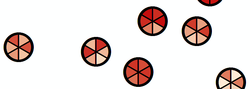

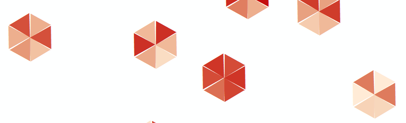

Here's how you can do it with six (just realized you need it for five, which would be more complicated):
- my features are points, at each location there are six points, each point has a rotation value in a field (0, 60, 120, etc.)
- make a triangle symbol with one point as close as possible to the symbol origin and colour by your attribute:
- make a copy of that layer and place above in the table of contents.
- symbolize that feature layer with copies of the circle/line symbol to hide the gaps between your triangles:
