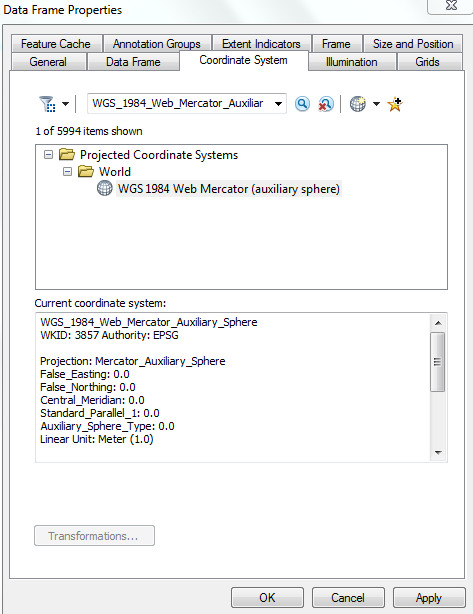

JayantaPoddar
MVP Alum
What is the coordinate system of the map? Try changing the coordinate system of the data-frame to WGS_1984_Web_Mercator_Auxiliary_Sphere (WKID: 3857).

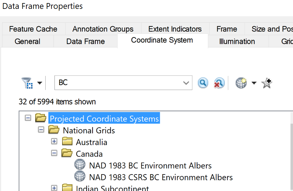

DanPatterson_Retired
MVP Emeritus
You have no projection set... BC has a couple of nice projections, you should use one to restore it's appearance to the grandure it deserves.  Go to Projected Coordinates, National Grids, Canada...
Then of course there are a whole load of non-BC names ones, which would also be appropriate.  I would check to see what other data you might be using from the province.  If you are using data from the Feds, then you may wish to adopt one of those projections as well.
