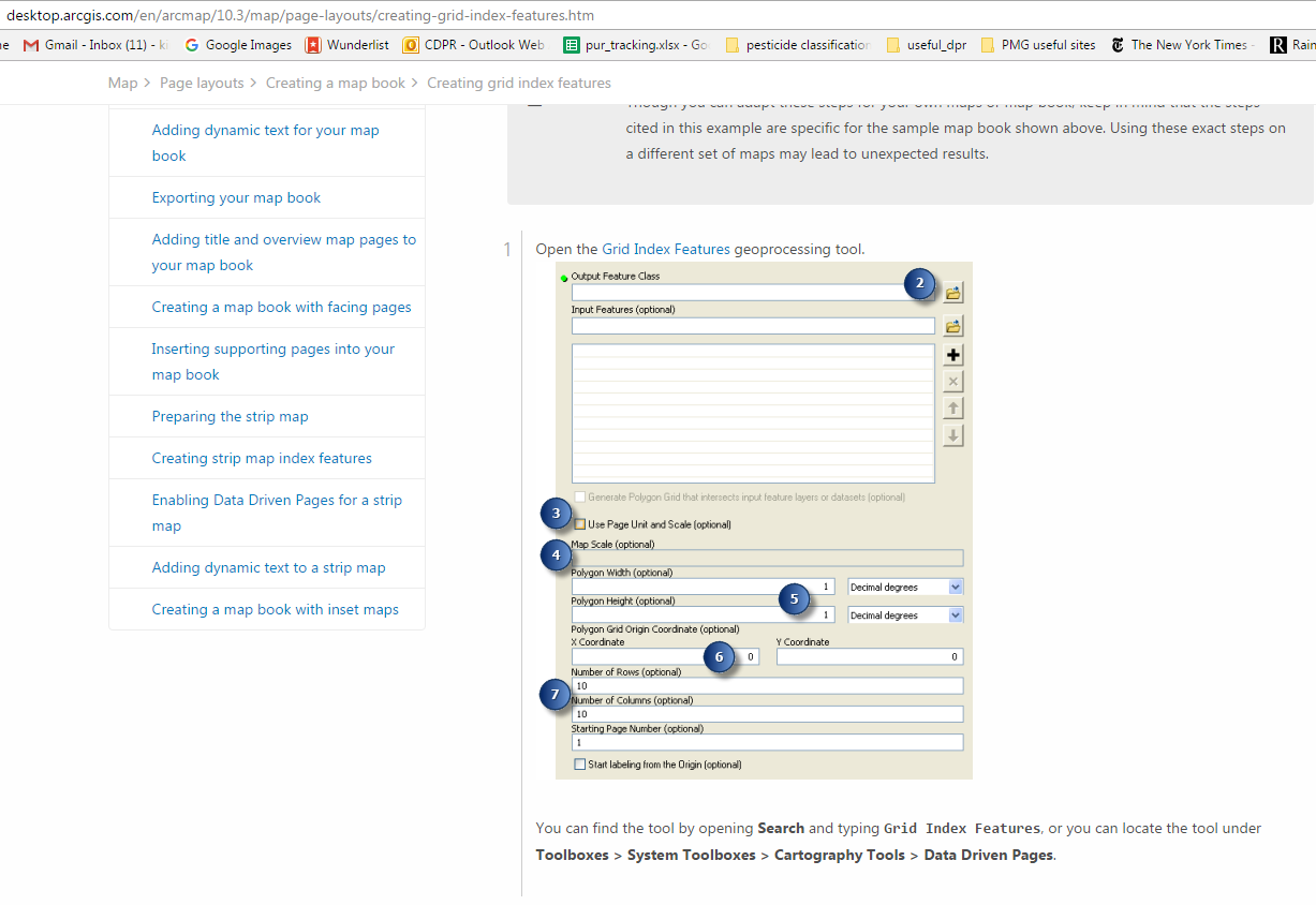

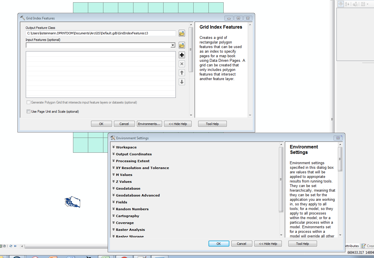

I am using the cartography grid index features tool for ArcGIS 10.3.1.my grid index feature tool
It does not appear to have all of the options and boxes that i see in the tutorials and instructions online
online grid index features tool

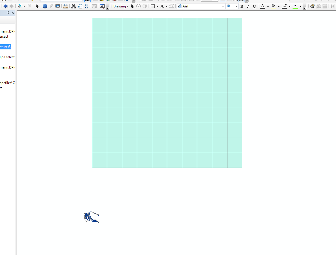

Here is the map i am hoping to make into data driven pages with a grid of square polygons
my map
I have tried all sorts of different combinations in the boxes. I either get one big square polygon over my map, or i get a giant grid of square polygons above my map (my map is the small blob in the lower left of the photo below).my grid
Any advice on what i am doing wrong?

I suspect your coordinate systems are at play, perhaps you have geographic data in a projected coordinate system but entering planar coordinates which are being interpreted as degrees.  Rectify or confirm that your data are in a useful projected coordinate system, then you can enter planar units

I think Dan is on the likely issue.
Also, a question - is the line layer (streets?) being used as the Input Features (optional) when running the tool?  Doing so will cause grids to just be created where the lines are.  If things are still going awry, can you post a screenshot of your tool settings input just before running the tool.

About the shift between the grid and your extend polygon is think it is coordinate system error like DAN said. may be your feature class has not defined coordinate system.
after you project your feature class make sure that you checked on Generate polygon Grid that intersect input feature datasets , to get the grid that you asked.
KimberlySteinmann
thank you all so much - i now have the grid i was looking for!
