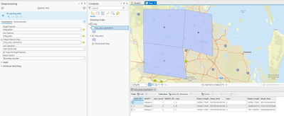

Use a Spatial Join with the "Boundary Touches" Match Option.  Add a def query to the result to exclude a zip code bounding itself.
Depending on how you'd like to see the results, you can use a Join Operation of "one to many" or "one to one."
For example:
