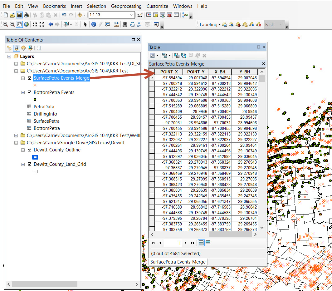

I'm still attempting to load well data from Drilling Info for permits in a certain county and have them connect the surface hole to the bottom hole with a line.  I've gotten to the step where I have added the XY using the XY Tool but they are in a feature not in the actual data table.  I need to get the XY data into a data table first, and then somehow merge the surface and bottom holes into the same document.
I need help with how to take the XY's generated in the point feature class table (see image) and move them to a data table?

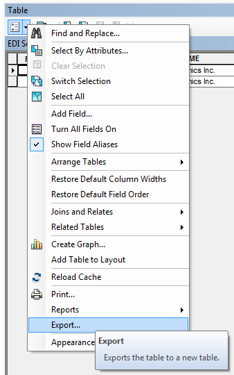

Not sure I understand, but you can export the feature class table to a standalone table, from within the attribute table options:

I started using GIS on Monday after a one day class.  I didn't learn about all the tools and where they were.  Thanks for letting me know about the export button, I will try that and see if that gets me closer.

Ditto with Darren here. I am a bit confused.
In the table you show, you have the XY coords twice. Why do that.
Normally, a drilling collar table (the location of the hole) would have a format something like this :
BoreholeID, CollarX, CollarY, CollarZ, Dip, Azimuth, EOHDepth.. maybe some other info here.
Usually it is easy to import this table (usually from excel), into a geodb, then make a PointZ feature from it.
I have a tool which can then generate a PolylineZM (the drill trace) from this. Its all done in python.
Unfortunately (at 10.3.1), the XY to line tool (in the toolbox) doesn't include the Z coordinate, so no out of the box solution.

This takes about two minutes to plot inside of Petra, and I'm trying to get it to work in GIS. I've written to another help board and was trying to follow the steps that person gave me to convert the Lat/Lon of the SHL and BHL to XY Coords and then use the XY to Line tool to connect them using the API #.  (I have no idea who has the best method so am trying several methods out).  This person further instructed me to then try to Merge the tables together (which I did I think).  Now I have all the XY's for the SHL and the BHL for the wells in the same point feature.
However, I need them in a table format in order to use that particular tool.  (Sorry if my explanation is long winded, or using the wrong terminology)  I'm literally less than one week into using this software.

If the double set of coordinates are simply the result of recalculating the geometry for that layer, then save it to a table as suggested, then you will have to join it to your other table Add Join tool if you intend to use it in the XY To Line Tool.  This would only be useful for a 2D surface representation. I assume you are trying to get this Feature To 3D By Attribute tool where you depths are in a different file

For this method, I don't need to use the directional surveys.  I simply want to connect them "as the crow flies" straight line from SHL to BHL.  I'm not trying to do a 3-D image or use the azimuth, TVD etc.  To clarify, I need to just do a 2-D representation.
The "double set" is from some method I did yesterday which I can't recall (possibly the copy rows tool?).  I took the XY's in the BHL table and just added two new fields.  I copied the BHL to a new field called BH_XY, and BH_XY etc. so that when I merged them together I could tell the difference between the ShL and BHL and didn't want to have issues when merging that I had two columns with the same name.

If all you require is a 2d representation of the drill path, all you need is
TopOfHoleX, TopOfHoleY, BottomOfHoleX, BottomOfHoleY in the same table.
Then you can use the XY to Line tool.
