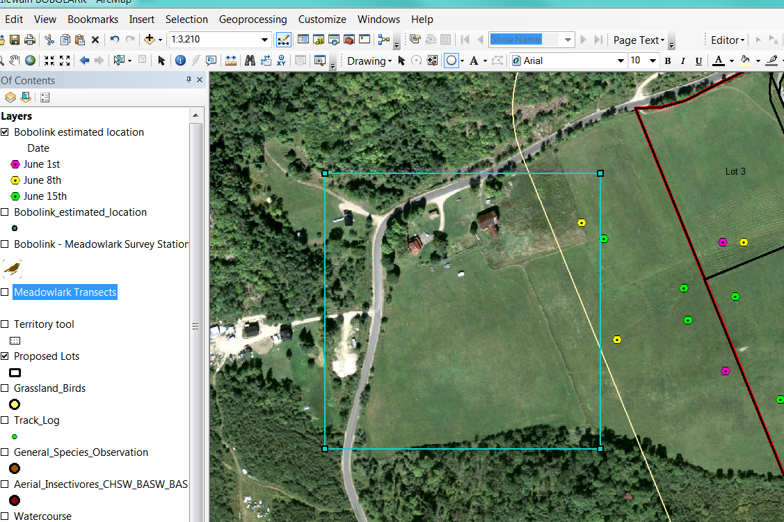

RebeccaGeauvreau
Hi Xander,
I think the coordinate system is ok; all other data is displaying & behaving correctly.  Attached is a screen grab - I used the circle tool and drew a circle; when I finish the handles are visible but not the circle.
MichaelAugust
So under "Drawing" dropdown - what is the active annotation group, and is it turned on?
RebeccaGeauvreau
default is now but I suppose it wasn't.  Funny how the simplest things cause such frustration!  Thanks again for your help
