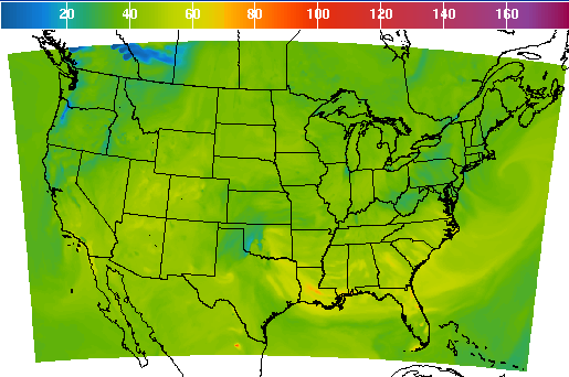

I'm not sure if this is something that can be done, but have created a custom color ramp in ArcGIS Desktop and would like to use a stretched symbology for a gradual transition from one color to the next, but need to assign static colors to specific values on the scale. This is my scale:
color ramp
For example, the possible range of values within my dataset (which is dynamic) can be from 0 to 500. The actual range will vary from day to day and won't always have a max value of 500. So, I need the color for say 55 to remain red regardless of the actual range of the current dataset. Sometimes the dataset will only max out at 55, but I don't want it to be purple/maroon, I need it to remain red. I don't have a dataset that has the full range of values in it. The max value I have is 114. Is there a way to do this??
I should also state that the original format of my dataset is grib which I've degribbed (to a .flt) and converted to an .img file. I believe there is a way to do this with a colormap but I'm having trouble finding a reference to manually adjust the max value since colormaps can only be used with unique values.
Here is an image of what I am trying to accomplish in ArcMap, with different color ranges:
example
