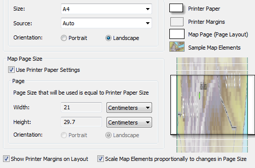

When we want to change the template we use the 'Change Layout'  button on the 'Layout' toolbar. However, when changing from portrait to landscape the map template shifts upwards and is no longer located in the print layout page! The image on the left below is a snipping of what happens. The template should be located in the print layout box. It also messes up the 'Page and Print Setup' box with these horizontal lines as shown below on the right.
The workaround so far is to change the page orientation first and then do the change layout. We don't think this was a problem in 10.0.
