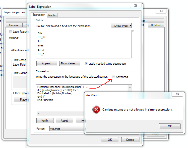

I have a label expression where I want to not display any building numbers greater than 1000. We went from 10.0 to 10.3. The script worked in 10.0 but not 10.3.
Function FindLabel ( [buildingNumber] )
if ( [buildingNumber] < 1000) then
FindLabel = [buildingNumber]
end if
End Function
Thanks for any help
Mike

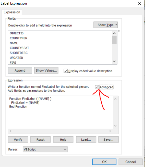

AdrianWelsh
MVP Honored Contributor
Mike,
Be sure the check the box for "Advanced" in the expression dialog:

MikeFroese
Deactivated User
I am using the same parser but get
'Carriage returns are not allowed in simple expressions.'

AdrianWelsh
Mike, can you make sure you are still using the same Parser to carry out this expression? It looks like this is for the VBScript Parser. It might be a good idea to make sure this is still the case.

AdrianWelsh
Mike,
MikeFroese
Deactivated User
WOW! Do I feel dumb!
I completely overlooked the check box!
Thanks
DarrenWiens2
MVP Alum
I'm at 10.2.2, but I get your error if I try to use the expression without Advanced selected.
