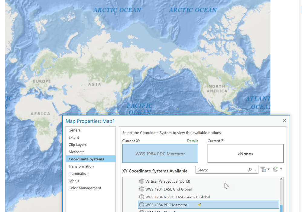

I need to make a world map like this on in the picture, but I don't know if I should look for an specific projection or ArcGis configuration.
*This is myu first post on this forum... please be gentle*
Cheers
DanPatterson
MVP Esteemed Contributor
WGS 84 / PDC Mercator - EPSG:3832
right-click on the Map title in the table of contents
Select "Properties", "coordinate system"
do the scrolling-thing until you find the highlighted one below.

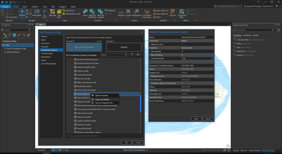

There are couple ways you can do this... I suggest the following workflow by customizing one of the existing projected coordinate systems designed for the world maps.
  1. Go to Map -> Properties -> Coordinate Systems
  2. In XY Coordinate Systems Available navigate to Projected Coordinate System -> World
    This is the list of predefined projected coordinate systems (PCS) that one can use to display whole world. Most of them are centered on Greenwich, but you can easily change that.
  3. Right click on, e.g. Natural Earth (world), and select Copy and Modify...
  4. Change the Name of your new PCS and adjust the Central Meridian value to something like 150 degrees.
  5. Save -> OK
