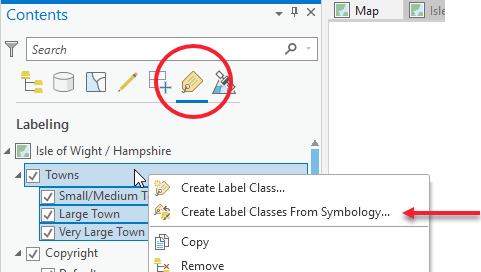

Hi, I don't see this option under my class for Labelling. Noticing that I have already created label classes from symbology classes?
Please advise?

To get to this option you need to be on the Labeling view of the Contents pane.  Then right click on the layer and select Create Label Classes From Symbology
You can find more information here
Use label classes—ArcGIS Pro | ArcGIS Desktop

Thanks Wnady. Good explanations.
I figure out that I am using V 2.2.0 in which there is no such option. Now I upgrade to V 2.4.0 and I get this option.
Thanks
