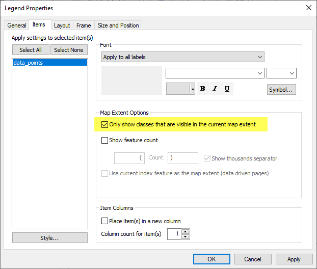

In the Legend Properties dialog, you have the option "Only show classes that are visible in the current map extent". Does this not work for your situation?
NitsGraff
!It does
I missed it somehow... thank you my friend
