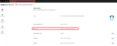

ahargreaves_FW
I asked Waze and the Org ID is simply the name you signed up with to the Waze community partner program here.
