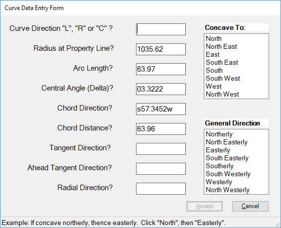

Chris,
Thanks that is great.
Attached are is the image:
There are a few angle modifiers that regularly show up in legal descriptions. For example, you have tangency, which you mentioned using the *tb phrase, noted as "tangent direction" above (there is also noted the more rare "ahead tangent direction" that is defined from the end of the arc, rather than the beginning). Glancing at the code you sent Adrian it looks like you may make use of negative radius to achieve tangent curves to the "left" or counterclockwise, and positive for clockwise curves (these are noted above as "curve direction". The "C" is for when someone notes the direction of concavity for the curve rather than saying left or right, or to describe the general direction of a curve. Which is a convention in some areas.
Perhaps you have some for other angle modifiers. Radial direction or radial point is a bearing to the center point of the curve. This is measured at the beginning of the curve. Chord direction we have already covered. Delta angles or Central Angles are very important, the curve will normally close best using delta and radius than with chord bearing and distance.
Do you have other phrases like *tb that you can input?

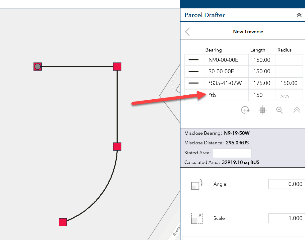

ChrisBuscaglia
Jeff,
The Parcel drafter supports tangent bearings, see the image below.  Using the shortcut *tb will set the course tangent.
Radial Bearings are NOT supported currently, will submit an enhancement request.
Can you send an example doc. my way?
