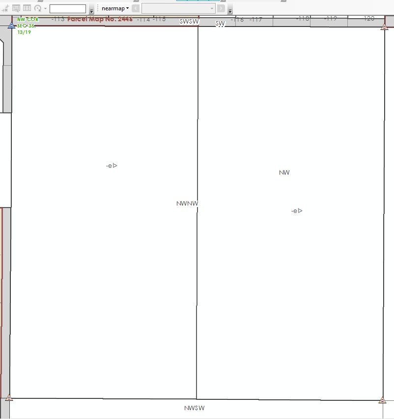

Below shows the process of building the parcels.
Step 1:  Isolate quarter quarter section.
Step 1
Step 2:  Split quarter quarter section into E and W half's (or quarter quarter sections depending on how tax parcels are laid out)
Step 2
Step 3:  Using property descriptions as described in step 5, construct the tax parcels.  Note that the parcels go to the center of the road.
Step 3
Step 4: Build exception (upper right parcel).  I had to also construct additional right of day dedications.
Step 4
Step 5: Construct subdivision boundary
Step 5
Step 6:  Build lots
Step 6
Step 7:  Add in remaining record maps, construct right of ways on tax parcels where needed, and construct parcels within the subdivision.
Step 7
