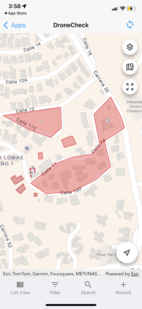

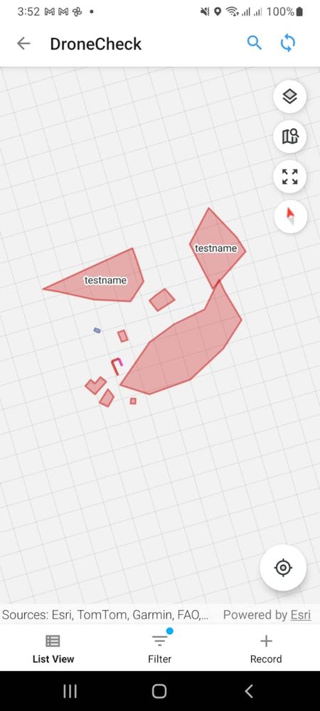

Hi @RamaChintapalli  thanks for answering, reviewing what you say that maybe we have empty strings, we already did that test, even the curious thing is that the labels are not seen in the same polygons in the two platforms, try in android to burn the attributes to show you that even so the labels are still not seen, I attach the portion of code of the test and the screens where you can see the test in android and ios that the same labels are not displayed either
