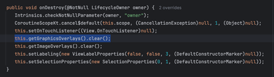

this.getGraphicsOverlays().clear();
takes too much time if being called right after graphics are added to the `GraphicsOverlay`

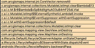

Here is the callstack: one could see `clear` takses mostly all the time of the `destroy` function.

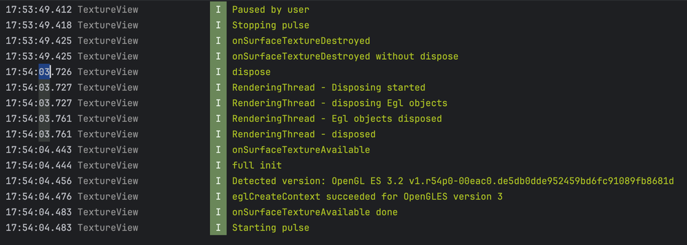

The issue is also seen in the LogCat (here are the logs for the Activity onStop/onStart lifecycle): TextureView disposing takes 15 secs
I want to emphasise once more what is weird: if we wait for 5-10 secs right after adding the items and before destroying the view, disposing works normally.
