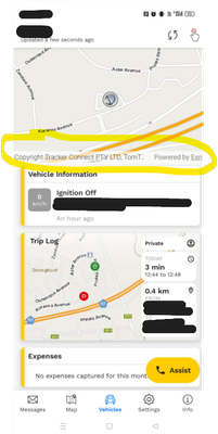

Hi There,
I am using Compose maps SDK ("com.esri:arcgis-maps-kotlin-toolkit-bom:200.6.0")
As shown in above screenshot the screen is developed in Jetpack Compose along with ArcGIS compose map. The map at the top shows the "Copyright Tracker Powered by Esri". How can we remove/hide it.

Hello,
That text is shown in the attribution bar. You can set its visibility by setting isAttributionBarVisible
property.
PuneetPrakash
FYI we have this issue https://community.esri.com/t5/kotlin-maps-sdk-questions/compose-mapview-ignores-isattributionbarvisi...
in the current release, the fix for it will be out in the next release.
