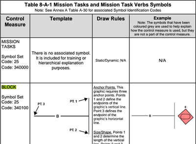

Anyway, what you've got for the 10012500003423000000 – is wrong (see Seize App6d symbol).
Meanwhile, could you please try 10012500003401000000? This should be Mission Tasks: Block – quite a simple symbol to draw with the help of CIMGeometricEffectControlMeasureLine

Ok, I guess I understand the problem you are running into.
The problem is setting configuration to `Ordered Anchor Points` without actual control points.
The purpose of this configuration is to draw the graphic or feature using the specified control points based as geometry and the correct symbol is returned. In this case it is important that geometry passed should have correct number of control points as defined in the standard.
Since you are just trying to get a swatch and there are no features or graphics being drawn, there are two options you can choose from. Both approaches listed below are just ideas and are not a resolution to your issue.
- If you want to just get a symbol for an sidc you could try to NOT set `Ordered Anchor points` configuration. That way stylx can return you the base template symbol. But, caveat here is base template may not look like actual symbol.
- If you do want the exact symbol then you should use CreateSwatchAsync() overload that takes a geometry and for that geometry you should pass in a polyline with right number of control points. Note, I have only tried `10012500003401000000` from App6d which looked and haven't tested more complex symbols. There could be issues with this approach as well and you need to know the right number of control points, define the right coordinates and right geometry type. So this is not simple either.
