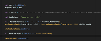

When I try to load a WfsFeatureTable from a WFS-Layer hosted on GeoServer, I didn't get Any error,but it Can't load wfs service correctly!
SDK Version: 100.15.2
Here is my wfs service url and tableName
http://47.114.126.208:5431/geoserver/tamp/ows?service=WFS&version=2.0.0&request=GetCapabilities
tableName = "tamp:pt_tamp_stake"

You would need to provide a call "populateFromServiceAsync" on the feature table to query the feature service and place the resulting features in the feature layer:
// create a query based on the current visible extent
val wfsQuery = QueryParameters()
wfsQuery.setGeometry(extent)
// choose the spatial relationship used for the query
wfsQuery.setSpatialRelationship(QueryParameters.SpatialRelationship.INTERSECTS)
// populate the WFS feature table based on the given extent
wfsFeatureTable.populateFromServiceAsync(wfsQuery, false, null)
