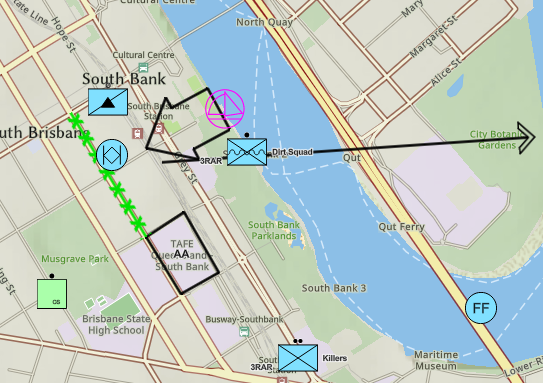

Hi All, I am seeking advice on an approach to enable moving multiple coordinate symbols such as the arrow line below via the mouse. I have no issues moving single coordinate symbols. My current code for a single coordinate is below.   Has someone developed or could share a method they have developed?

I don't have any specific code to do what you are looking for, but I'd approach it something like this:
  • When you identify or get the geometry of say an arrow you you'll get back a MultiPoint which will contain the control points for your arrow.
  • You should be able to work out a delta x and y from your dragging operation.
  • You can create a new MultiPoint by looping through the points in the old geometry, apply the delta to each point and then set the new geometry to your graphic.
Does this help?
