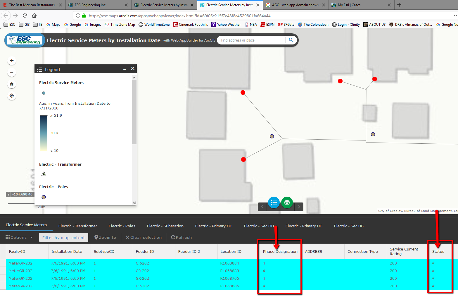

When you select records, however, the Attributes in the Table view and the Pop up window show the Domain Code and not the Domain description.

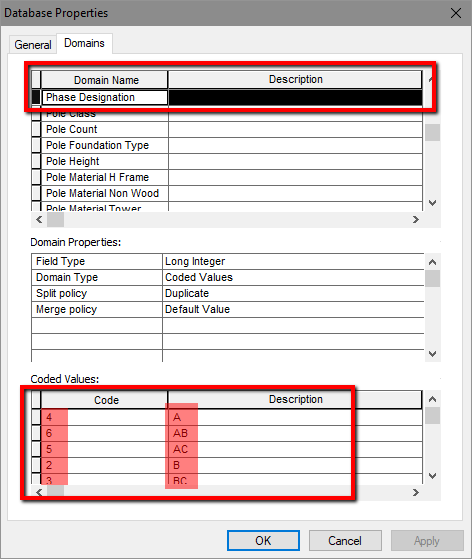

In the Domain here, you can see the Codes and Descriptions.
the value for Phase Designation on the 4 selected records -> 4 above should be showing as A

I double check that the Field indeed has the Domain applied in the File Geodatabase uploaded:
Check!
