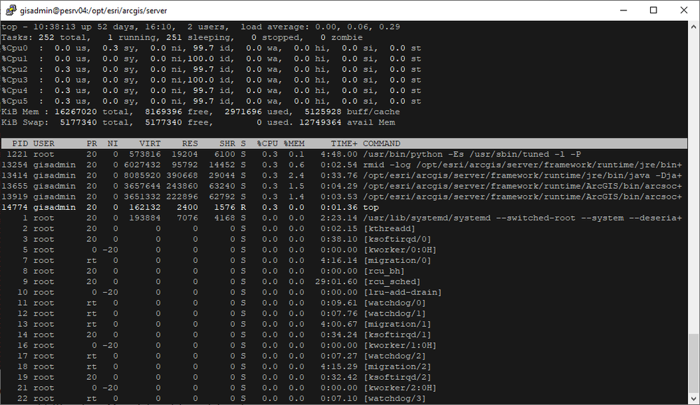

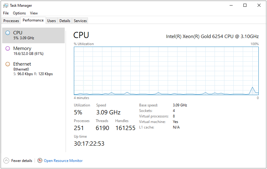

Note: Using tools like Task Manager (for Windows) or top (for Linux) are great tools for manually getting a quick view of system resource utilization. However, these are not ideal saving the usage from all the categories to a file.
  • Task Manager's view of system resource utilization (Windows):
  • top's view of system resource utilization (Linux):

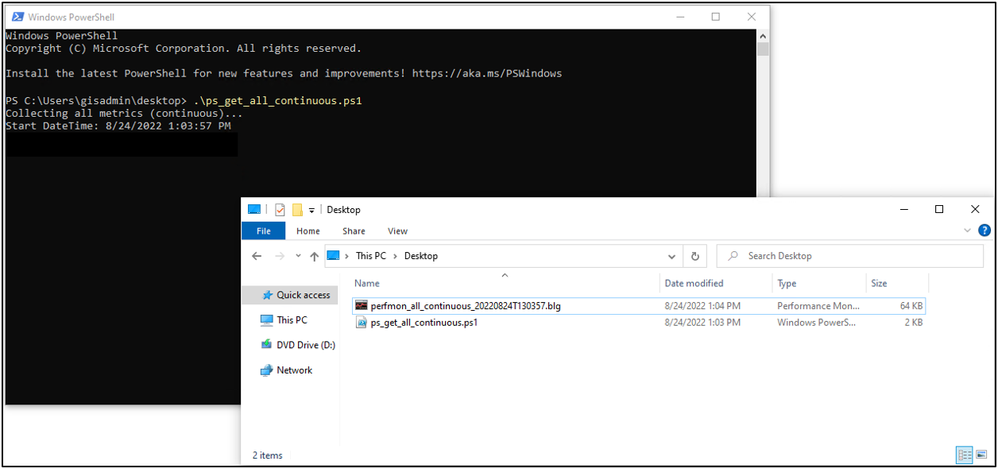

Instead, the recommended strategy for this methodology is to use a PowerShell script where all of these items are predefined.
  • The following will gather key perfmon metrics (that are already defined) from the four primary hardware categories and will do this for four different machines (that you can specify):
# Updated:      2022-08-02
# Filename:     ps_get_all_continuous.ps1
# Version:      0.1.0
# Desc:         Continuously collect various metrics and save (binary) values to a file
# Notes:        It is recommended to start the metric collection 20 seconds before test starts
#               as counter initialization can take some time
Write-Output -InputObject 'Collecting all metrics (continuous)...'
# Variables
# Windows Perfmon Counter(s)
$counters = "Processor(_Total)\% Processor Time","Memory\Available MBytes","Memory\Committed Bytes","Memory\% Committed Bytes In Use","Network Interface(*)\Bytes Received/sec","Network Interface(*)\Bytes Sent/sec","LogicalDisk(_Total)\% Idle Time","LogicalDisk(_Total)\Disk Read Bytes/sec","LogicalDisk(_Total)\Disk Write Bytes/sec"
# Machines to collect from
$computers = @('server1.domain.com','server2.domain.com','server3.domain.com','server4.domain.com')
# Time in seconds between each sample collection
$sampleinterval = 10
$date = (Get-Date)
$dyndate = '{0:yyyyMMddTHHmmss}' -f $date # 20220303T140044
# File name
$filename = "perfmon_all_continuous"
# Output file type (choices are blg, csv, or tsv)
$outputfiletype = "blg"
# Output file
$outputfile = '{0}_{1}.{2}' -f $filename, $dyndate, $outputfiletype
# Get-counter
Write-Output -InputObject ('Start DateTime: {0}' -f $date)
Get-counter -Computername $computers -Counter $counters -Continuous -Sampleinterval $sampleinterval | Export-counter -Force -FileFormat $outputfiletype -Path $outputfile
  • The metrics are collected every 10 seconds until you hit Ctrl-C in the PowerShell window. The information is saved in a binary formatted file that you can open in Windows (for further analysis or transformation):
Note: It is recommended to start this Powershell script about 20 or 30 seconds before your start the load test as counter initialization is not immediate and takes a moment or two.

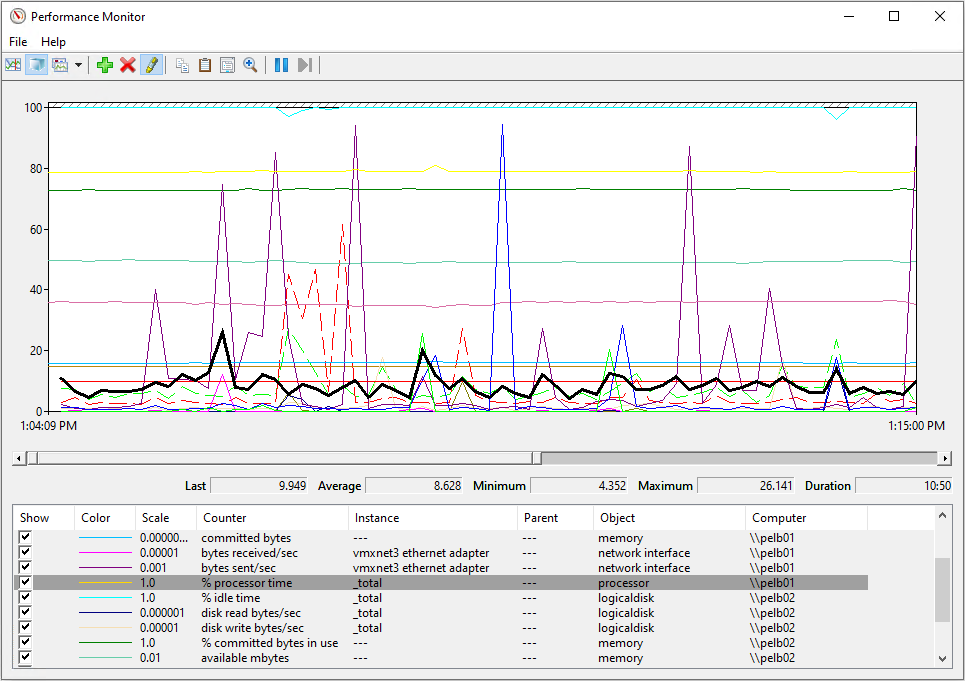

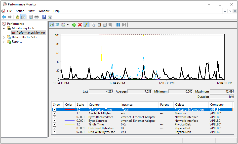

  • You can open the *.blg file at any time during the capture, but the latest information is not flushed and saved to the file until you hit Ctrl-C from the PowerShell window where the script is running.
  • Double-clicking and opening the *.blg file should look similar to the following:
The end result is an output that looks very similar to what we captured. However, in this case, the process has been automated (which is a good thing).
From this interface in Performance Monitor, you can select/deselect metrics for specific isolation, export the graph as an image, save the raw data to another format like CSV, or conduct usage analysis from all of the collected machines. Pretty powerful!

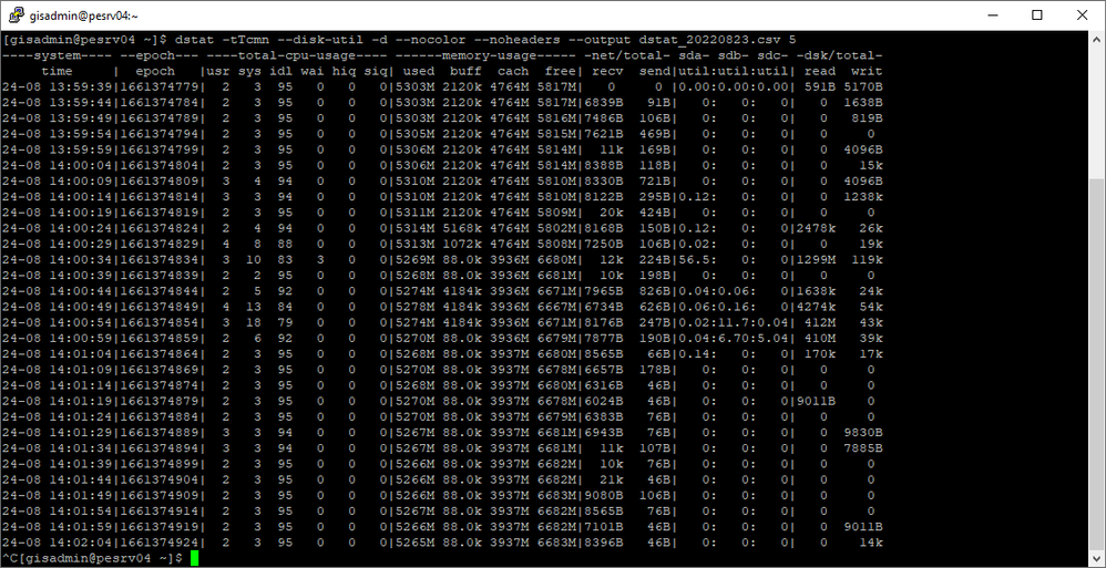

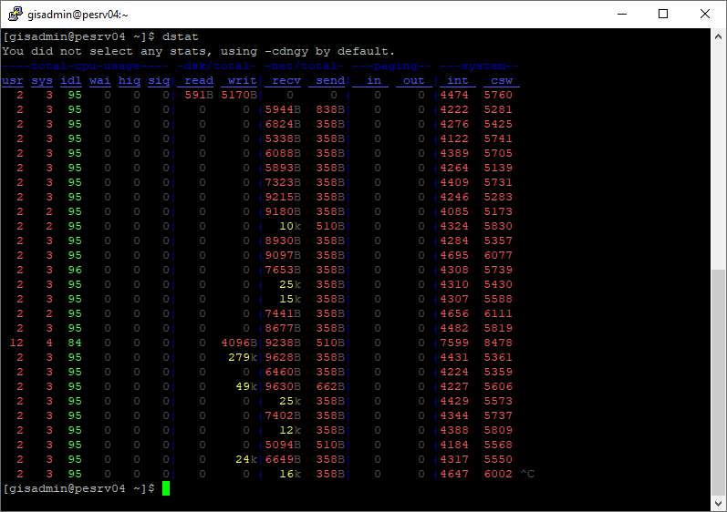

Using dstat (To Capture Utilization Outside of Load Test)
dstat is a free command line tool (written by [email protected]) available for (or with) most Linux distributions that captures (and monitors) hardware utilization.
Although the utility has not been updated for several years, it is fairly robust and easy to script.
  • dstat terminal output with running it with no options:
The following will run on your Linux server and capture hardware usage to a csv file every 5 second until you manually stop it with Ctrl-C:
  • [gisadmin@pesrv04 ~]$ dstat -tTcmn --disk-util -d --nocolor --noheaders --output dstat_20220823.csv 5
Note: With dstat, the captured processor usage is "idle time percentage", not usage percentage. To get the usage percentage, subtract 100 from the value . However, the disk utilization is in a usage percentage. Additionally, the output above includes a presentation format so the raw values (not shown) for memory, network and disk are saved as bytes.
Note: dstat scripts would need to be run manually and separately on every Linux machine in the deployment. They do not directly integrate into JMeter. Once a load test is done and the scripts stopped, the CSV files can be collected and analyzed (e.g. plotted or charted in a spreadsheet program).

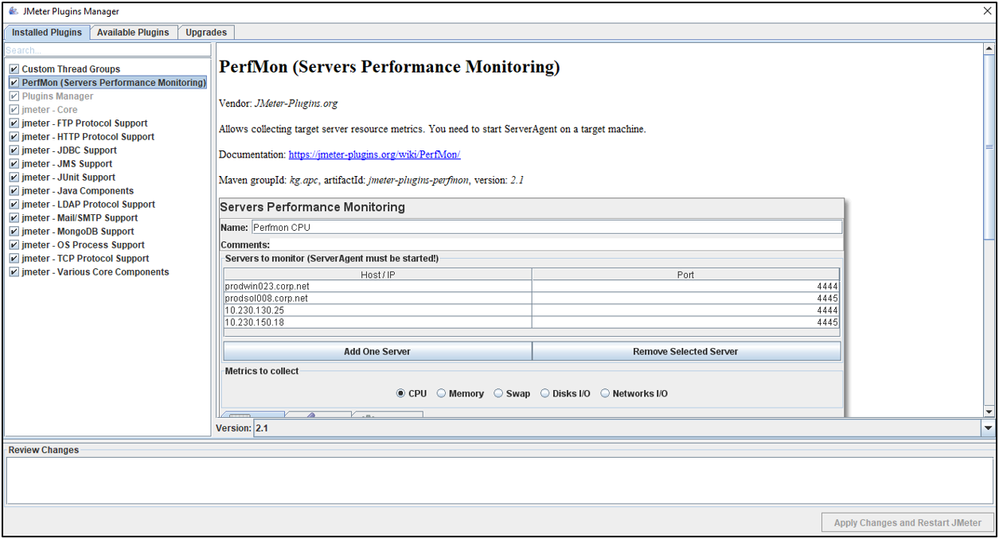

      • The jp@gc - PerfMon Metrics Collector extension that is added to JMeter
        • This component is used to define what metrics to collect and from which machines
      • The PerfMon Server Agent tool that runs in a Java Runtime Environment (JRE) on each server in the deployment
        • This component does the actual collection on each server and sends the data back to the JMeter
The jp@gc - PerfMon Metrics Collector component can be easily added to the Test Plan through the JMeter Plugins Manager (found under "PerfMon (Servers Performance Monitoring):

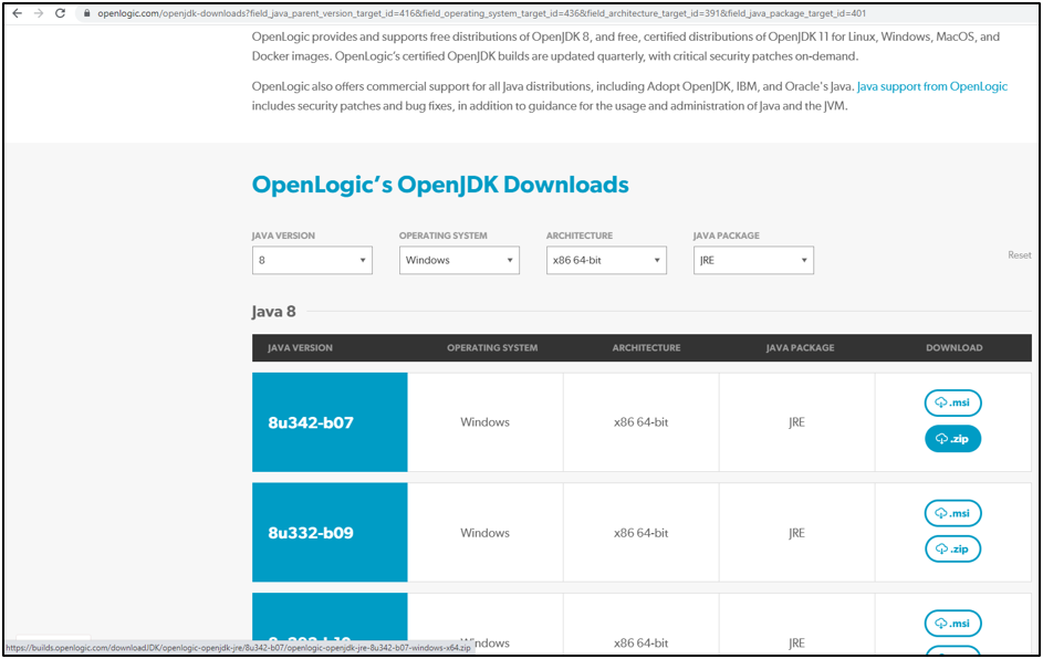

OpenLogic provides free, periodically updated v8 OpenJDK (and JRE) releases to download for Windows, Linux and Mac. Although the JDK would work, the JRE is recommended in this case as it is a smaller package to download but still provides the environment needed for the agent to run.
Note: Either the 32bit or 64bit JRE will work for the ServerAgent.
Note: The OpenLogic JDK or JRE can also be used to run Apache JMeter itself.

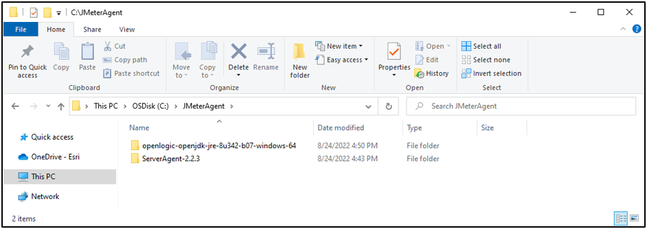

  • The ServerAgent and OpenLogic JRE unzipped in the same folder:
  •  The OpenLogic JRE moved into the ServerAgent folder:
  • Open the startAgent.bat file in an editor and update it with the name of the JRE directory that was copied into the ServerAgent folder:
 off
set JAVAPATH=.\openlogic-openjdk-jre-8u342-b07-windows-64\bin
%JAVAPATH%\java -jar %0\..\CMDRunner.jar --tool PerfMonAgent %*
  • Save the changes
  • The C:\JMeterAgent\ServerAgent-2.2.3 folder now has a self-contained ServerAgent that can be copied over to the appropriate machines for collecting their hardware utilization

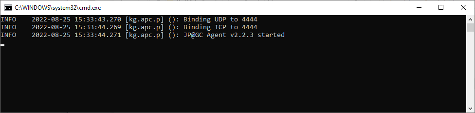

  • To start the agent in Windows, double-click on the startAgent.bat
    • The agent will launch into a command window:
  • The agent will not start "collecting" metrics until directed by the Apache JMeter Test Plan
    • By default, the agent and JMeter will communicate with each other on TCP and UDP port 4444

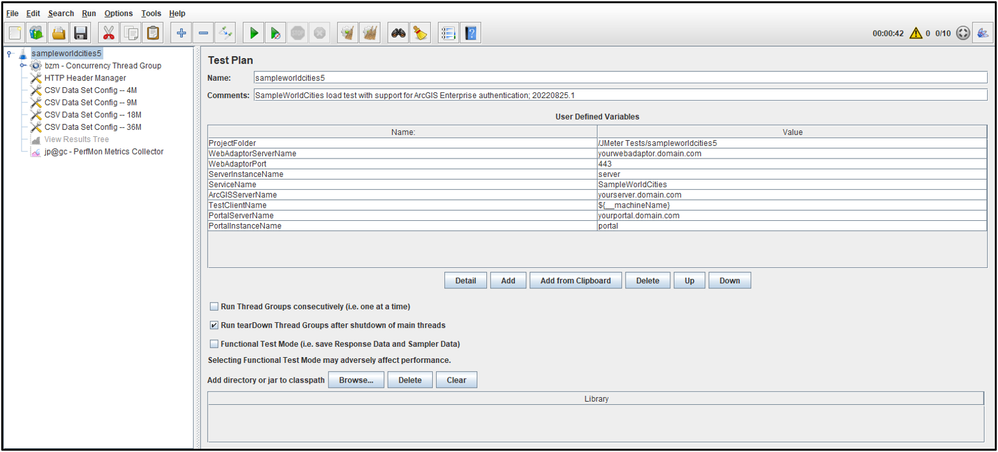

The SampleWorldCities Test Plan With Metric Collection Support
  • To download the Apache JMeter Test Plan used in this Article see: sampleworldcities5.zip
  • Opening the Test Plan in Apache JMeter should look similar to the following:
    • Adjust the User Defined Variables to fit your environment
      • This test defines four different machines to collect hardware utilization from:
        • A web adaptor
          • The requests are also sent to this endpoint
        • An ArcGIS Server
        • A Portal for ArcGIS
        • The Test Client (the machine running JMeter)
          • The hostname of this machine is auto-detected by JMeter when the test runs

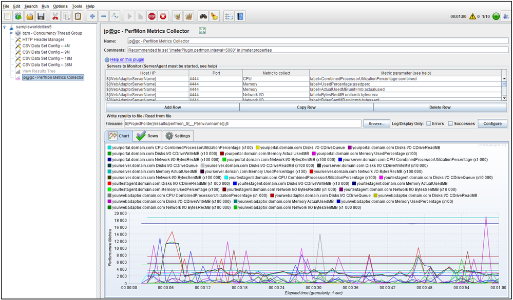

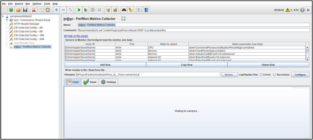

The jp@gc - PerfMon Metrics Collector extension is the only element of interest here as this test is practically identical to previous Article Test Plans for SampleWorldCities.
jp@gc - PerfMon Metrics Collector Extension
As mentioned earlier, the extension is what tells each running agent what it want them to collect. The Test Plan available in this Article has already added the counters for each of the four primary hardware categories.
Note: The metrics parameters will work for Linux and Mac. However, the Disks IO metrics are in the extension are configured to collect on the C drive (e.g. C\:\) which does not exist in Linux. This would need to be changed to /.
Validate the JMeter-to-ServerAgent Connectivity
Start the test from the GUI by click the play button (green triangle)
  • If all the ServerAgents are running and reachable on all the intended machines in the ArcGIS Enterprise deployment, they should be able to collect utilization and send the information back to the Test Plan
  • As JMeter receives this information it will display the information in the Chart tab
    • Let this collect for a few second to validate connectivity then stop the test

General Methodology Guide
This guide is not intended to be comprehensive covering every hardware utilization capture scenario.

      • Capturing Windows usage from Windows
    • Difficulty
      • Easy/Moderate
    • Recommended Methodology
      • Windows Perfmon (via PowerShell script)

    •  Servers
      • Windows/Linux
    • Environment
      • On-premise
    • Collecting Machine (Test Client)
      • Windows
    • Description
      • Capturing Windows/Linux usage from Windows
    • Difficulty
      • Moderate
      • JMeter Perfmon Extension and ServerAgent

    •  Servers
      • Linux
    • Environment
      • On-premise
      • Windows/Linux
    • Description
      • Capturing Linux usage from Windows/Linux
    • Difficulty
      • Easy/Moderate
      • dstat command or script
