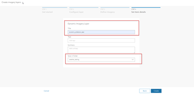

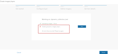

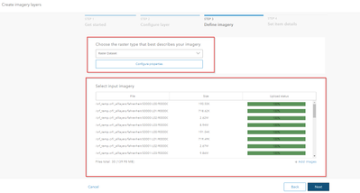

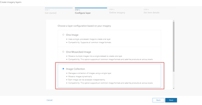

I am trying to create a Image Collection in AGOL Image and am having issues. I select the Dynamic Imagery Layer and then Image Collection and upload my CRF. (I have also tried NetCDF and GRIB) For the raster type I use 'Raster Dataset' when using CRFs, GRIB when using GRIB and NetCDF when attempting that. For some reason whenever I try to create it, it always fails with no explanation why.
If I select "One Image" instead of "Image Collection" in the Dynamic Imagery layer and use the exact same CRF, it works with no issues.
I am thinking that this is a bug and am curious if anyone else has had a similar experience or if I am doing something completely wrong. Looking at the network traffic I see this error which I will post the full JSON response below with screenshots. Any input on this would be VERY much appreciated.

I this option was never presented to me in the creation, so I am not sure how to fix this. Also this:
            "type": "esriJobMessageTypeError",
            "description": "Failed to create image collection: Start Time: Thursday, January 4, 2024 6:59:25 PM\nFailed to execute. Parameters are not valid.\nERROR 000735: Output Location: Value is required\nFailed to execute (CreateMosaicDataset).\nFailed at Thursday, January 4, 2024 6:59:25 PM (Elapsed Time: 0.02 seconds)"
I specified the folder that I wanted to place the Image Collection in, so maybe this is a bug?
