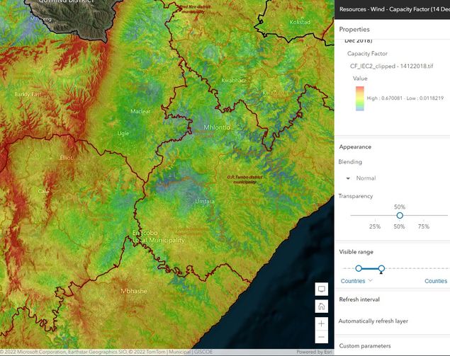

Thanks for your response. Please can you advise how you managed this approach so I can try to replicate it on one of my web layer rasters, and example of which is included below. I am using AGOL and not my own web server.

Is that layer public?  Or simply on ArcGIS Online within your organization? If you share its URL I can be specific, but here is some general stuff. Depending on they type of layer, enabling the pop-ups on that layer should reveal their pixel values if they are a imagery layer from ArcGIS Image for ArcGIS Online or an image service. If the layer is a tile cache or map image, then the pixel values will not be visible.

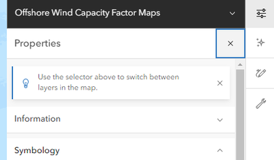

Here is a map image layer (map service) so this one will not have access to the pixel values.

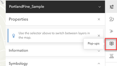

A quick reminder is looking for the Pop-ups button amongst the properties for the layer. As you can see here the pop-ups are not available.

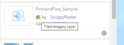

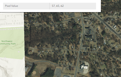

The layer I used was from ArcGIS Image which makes all the cell/pixel values available. You can see the icon for the layer is a little different.
So if you do not own the layer, but want to see the pixel values, you have to enable the pop-ups here.

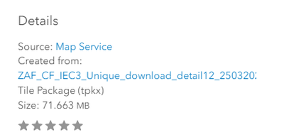

I see that the layer I created (https://tiles.arcgis.com/tiles/1JzTHhMEiV3vKRuI/arcgis/rest/services/ZAF_CF_IEC3_Unique_download_det...) is a Tile Layer (hosted) map service (see image below)
What do I need to upload this file, from ArcPro, as in order to allow the pixel values to be accessible? Previously I have linked a vector point file with the data to 'enable' values, but this consumes so many credits that it makes it extremely prohibitive.
