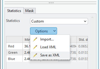

Hi there!  thanks for this detailed request.  I brought this up with our raster team, and they mentioned that you may be able to do this today in ArcGIS pro.  Can you please give this a try and see if it meets your needs?
Thanks!
--Stephanie
  1. Turn on DRA (from the Raster Layer tab).
  2. Click on the Lock Stats button (also on the Raster Layer tab).
    So we made this workflow even easier by putting everything on the Raster Layer tab.  Very few users exported the stats, so that remains on the Symbology pane.
  3. In the Symbology Pane, in the Statistics section, click on the Options dropdown arrow and choose Save XML
anpe00
Hi Stephanie
Thanks for your quick reply and suggestion.
You are absolutely right about the abaility to export the basic statistics (min, max, mean stdv)  using the method you are showing. However the problem is that there is no HISTOGRAM exported!
With arcMap the HISTOGRAM is exported together with the basic statistics.
I want that capacity to be implemented i ArcGIS Pro as well.
