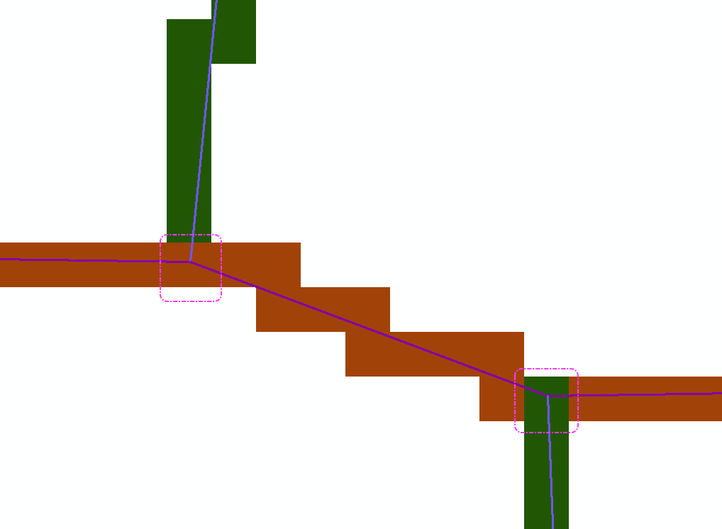

Hi,  I have a road feature class.  I want to change the vector lines to raster values.  Is there any easy way to specify cell value by preference at junctions?.  For example, Road type A with Road B at a T junction.  Some times it chooses to make the cell  Road Value A some time Road Value B.  Two junctions below.  Western junction takes value of Brown.  The Eastern junction takes value of Green.   For my use I want the cell to always take A value at junctions of A/B .
I am using Arcmap 10.6.1. Raster cell size is 1m.

The output is the position of the raster with the lowest number for that cell. Ie. Its saying raster 3 has the lowest, faster 2 has the lowest etc. On a cell by cell basis. Dependent on the order you add them to the tool.

Create a taster for A and a taster for B.
Ensure the same cell size and snap raster are specified in the environments.
Turn NoData values to 0 in both tasters (reclassify). Add together both rasters in raster calculator.
Reclassify the output raster values. E.g. if A =1, B = 2 there will be a raster cell with a value of 3 at the junction. Turn this value back to 1.

Looking at this as an option but it does become complicated with more layers.  Also looking at varying the cell size and the Lowest Position tool.

In your example, a majority filter with FOUR for number of neighbors should work in most situations

My shotgun approach to exploring ESRI tools has lead me to a solution to my problem.  I export each Vector by classification [five classes for my data], rasterise each independently and  add them together using Cell Statistics with MIN overlay statistics and I get what I need.    The lowest value at each junction being selected.  Again thanks to everyone for helpful suggestions.
