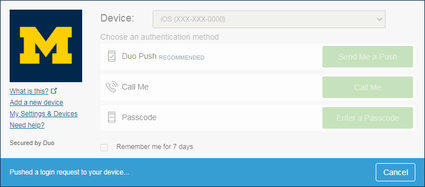

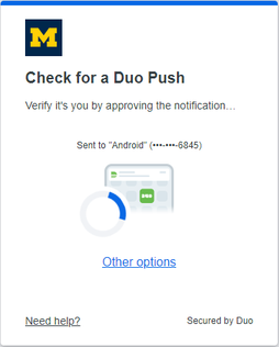

If you are wondering if your institution is using the traditional or universal DUO prompt, below are examples of what they look like here at the University of Michigan. Yours certainly will vary.
Traditional:
Universal:

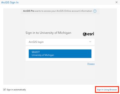

And, if you are wondering about the "Sign In Using Browser" workflow. The link is located on the Pro login page in the bottom, right. For example, the ArcGIS Pro login dialog looks like this at the University of Michigan:
Note that you can also set "Sign In Using Browser" to be the default via the Portal settings page in Pro by checking the box for "Sign in using browser", or via the registry setting, HKEY_CURRENT_USER\Software\ESRI\ArcGIS Online For Pro\SignIn
