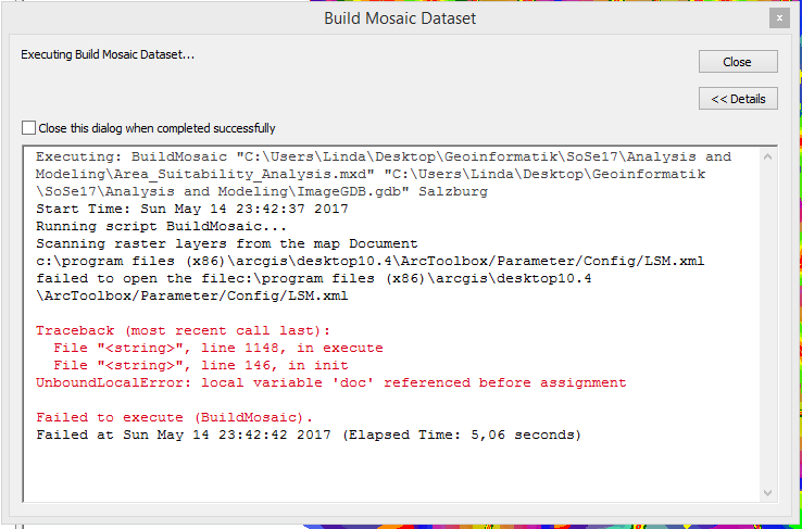

The last step of the preprocessing I’m supposed to use the Build Mosaic Dataset tool, which fails to execute. I don’t know what the error message means.

Hi Linda,
Sorry to hear that you are running into difficulties. We just had our annual user conference in San Diego and I could not reply until now.
Regarding this issue: Local variable doc referenced before assignment
When you download and extracted the .zip from github, did you copy the toolbox to another location? As in, did you move it from weighted-raster-overlay-service-toolbox-master\weighted-raster-overlay-service-toolbox-master\WROS\Tools to another folder and then execute it from that folder? If you did, this may have caused the problem as it has dependencies on some of the files in the other folders within the WROS directory.
