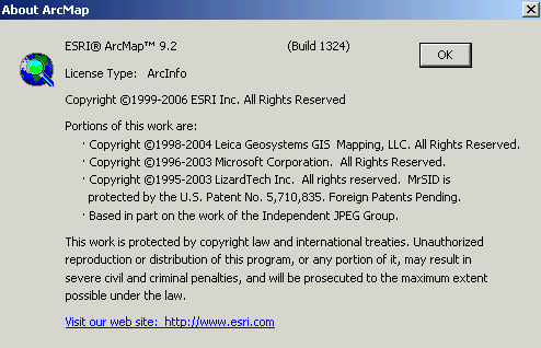

Although I don't have screenshots from that time, fortunately my agency's Wayback Data Center still has ArcGIS 9.2 installed, build 1324 nonetheless!  Let's role the clock back and see the in-memory workspace at its beginnings.

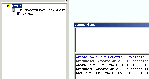

One of the simplest examples I can think of is to create a new table in-memory:
So, let's take a look at the Source tab in the Table of Contents:

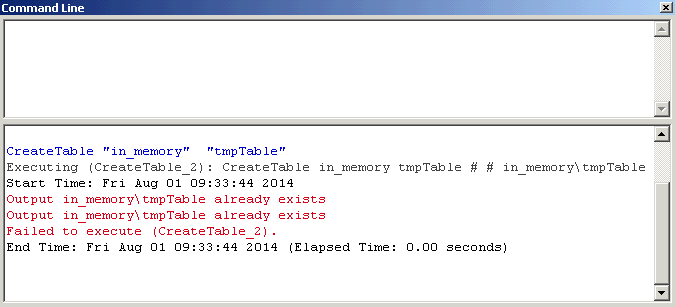

There it is, a new table in the GPInMemoryWorkspace.  What about creating the same table again:

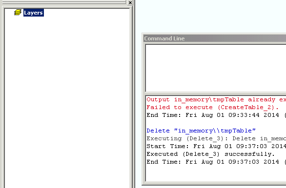

So far, so good.  We expect an error given that the table already exists.  Let's take a look at the Table of Contents after I try deleting the in-memory table:
Still going well.  The Delete command works and the in-memory table is gone.

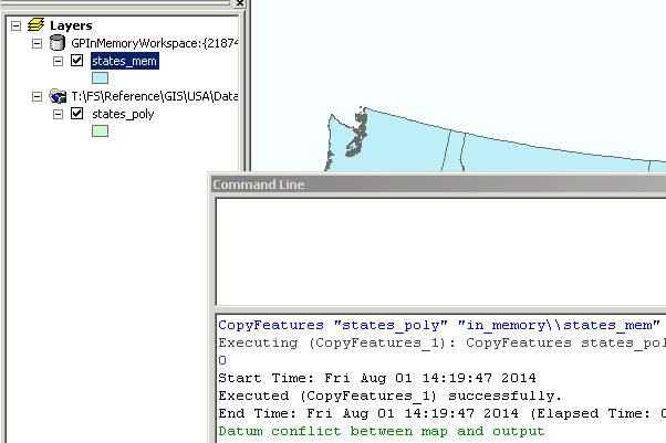

Looking for an example that actually involves some data, I loaded a feature class containing the U.S. State boundaries into ArcMap.  A simple Copy Features command using in_memory should do the trick if in-memory workspaces are working as advertised.
Well, there we are, a copy of the features loaded into an in-memory workspace.
