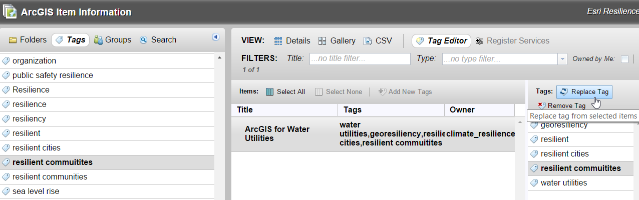

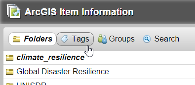

(3) Click Tags to view all your tags. If logged in as an org Administrator, you will see all tags used in your organization.
(4) Locate the tag you want to change in the list and select it. In this case I found the misspelled "resilient commuitites" in the list of tags that I have used.
(5) Items that use the selected tag will be displayed. Click the tag you want to change, and choose replace tag.

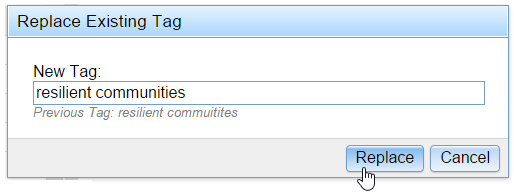

(6) Enter the new tag, and choose Replace.
The replacement or deletion happens on all selected items that you own, or if an Administrator, on all selected items owned by members of your organization.
