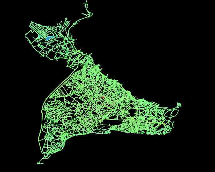

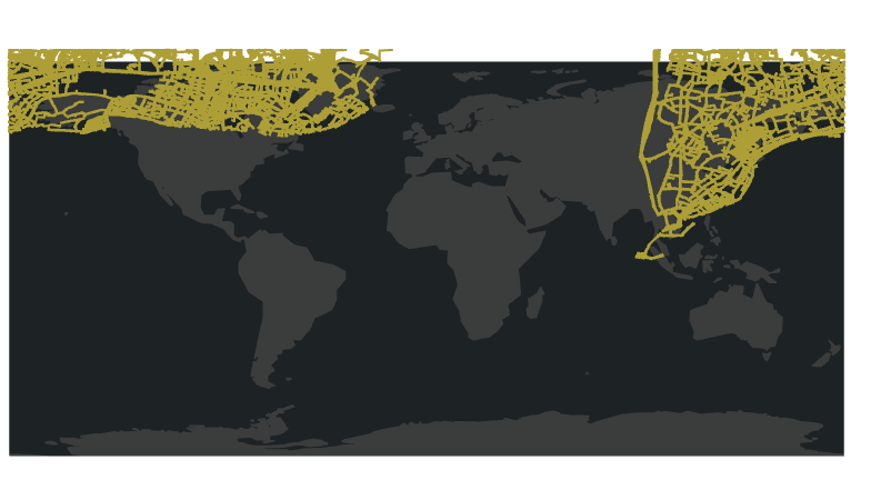

I have the same error ("Warning 000072: Cannot process feature with OID -1"). I check the file there is no any NULL. Then I converted CSV file to Excel sheet using "table to table" but I still got the same error. Some lines appear on the map but not all of them. Also, the lines on the map seem to move out of the map. The original image should be the image named 1.jpg. But the error I get is the image named 2.jpg. Would you please help me?

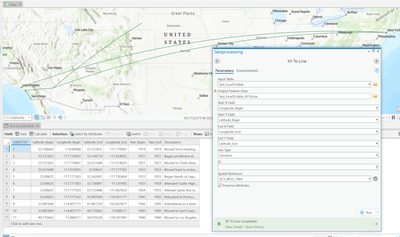

JoeBorgione
MVP Emeritus
It works for me...
I made sure that the Lat Long data in the excel worksheet were numeric in type before converting it to a table.
That should just about do it....
dzsiegel
Thanks for your patience and showing me your work. I'm too embarrassed to say what the actual issue was, but it suffices to say that your screenshot allowed me to realize my very fundamental issue...
Cheers!
JoeBorgione
MVP Emeritus
Let me guess: latitude and longitude values swapped?  Happens all the time! (I had to double check myself before I ran the tool...)
