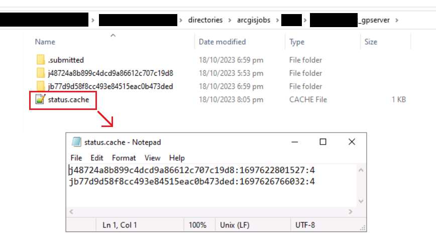

Noticed a file titled status.cache in all the Asynchronous Geoprocessing (GP) service folders inside arcgisjobs folder.
  1. What is the use of status.cache file?
  2. How to interpret status.cache file?
  3. Is there a way we can configure GP service not to read/write from/to that file?
