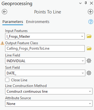

I wanted to use the "Points to Line" tool in AGP 3.2 to let it do what its name says - group points in a shapefile based on a text field and then connect them, based on a date field, with all environment values on default. However, when running, the tool mostly gives me zero-length lines for every point (there a a view groups with only one enty, but the far majority have 2-20 entries). A few lines, always only connecting 2 points are drawn on the map. However, when I select them on the map, no selection is made in the attribute table and when I select them in the attribute table, no selection is made on the map. The behaviour is idential with the shapefile having projected and geographic coordinates.

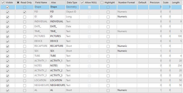

what does the table entry look like? and the dialog parameter selections?

For the "Line Filed (grouping) I use the field "INDIVIDUAL" which is a 9-character text string in the form of "i20-m-123", for the "Sort Field" (ordering), I use the filed "DATE_" which is of the date-data type in the form of 01.01.2023. I tried to create alternative grouping and sorting fields (ID & ORD) with manually entered short integer values, corresponding to INDIVIDUAL and DATE_, but this only yielded the identical corrupted results as described before.
