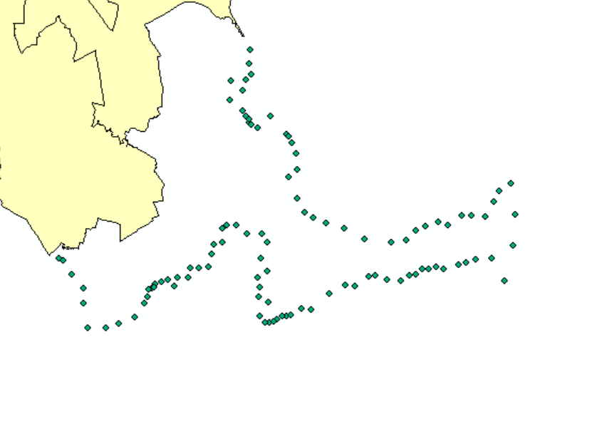

I have a shapefile of points:

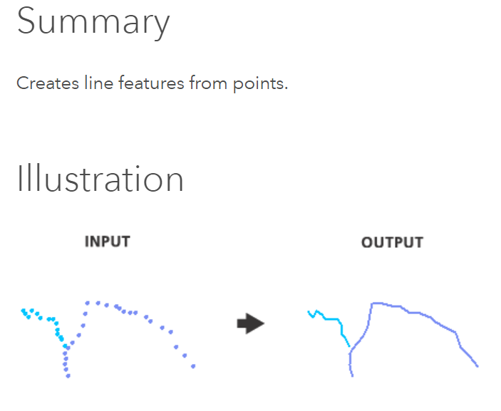

From the Points to Line help (Points To Line—Data Management toolbox | ArcGIS Desktopthis is a graphical representation of what the tool does:

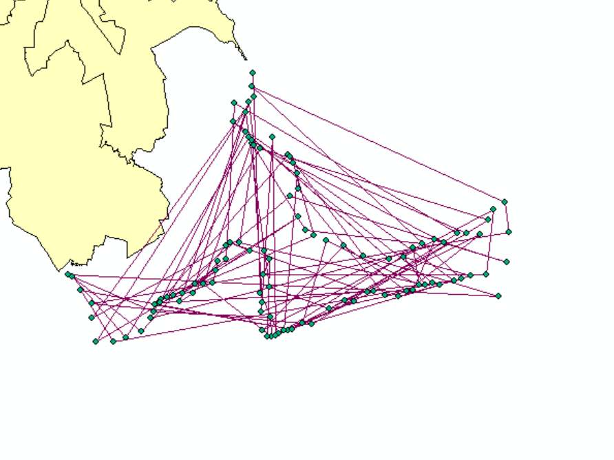

What I'm hoping for is roughly the same thing, i.e. the line my 5 year old would draw if I asked him to connect the green points. But instead, I'm getting this:
I'm leaving Line_Field blank, Sort_Field blank, and have tried both checking and unchecking Close_Line
I know I want to leave Line_Field blank because I want all points treated the same way. I'm also leaning towards leaving Close_Line unchecked because I would eventually like to use the (correct) output line to connect with another line to make a polygon, so I don't want the end vertex to be the same as the start vertex. But I'm open to ideas about the Sort_Field. The description of the default behavior is that "points used to create each output line feature will be used in the order they are found."

on first glance, it appears that your points are not sequentially ordered by their appearance in the table, but the order depends on some other field... do you have a field in the table that can provide the ordering?
SarahHugenberger
It appears to be using FID to sort. I had hoped that "in the order they are found" meant that it would use some kind of nearest neighbor algorithm and not just pick a field to use. If I had wanted them ordered by FID I would have put that into Sort_Field. And I have no other fields that would get me what I want.
