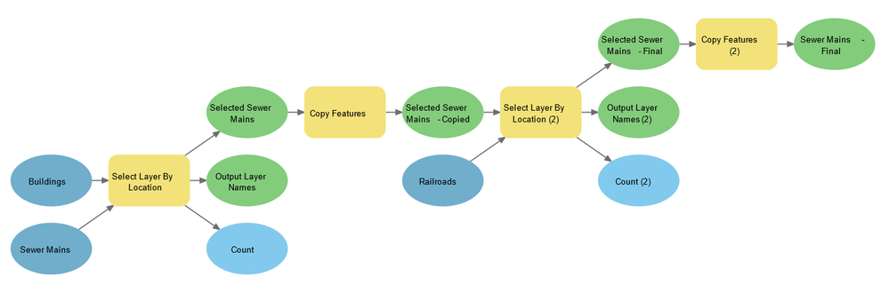

@MPach ,
This modelbuilder does what you are after if I understood your workflow correctly:

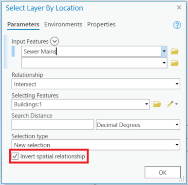

Make sure the first Select Layer By Location has Invert spatial relationship ticked on.

MehdiPira1
@MPach ,
MPach
Hummm,  that's an interesting idea. I don't know if even saw that being an option. I have to test it first and see what happens. Thank you. Also, regardless of that solution you led me to find the Get Count tool, which I had forgotten about, and I bet I can make that work too.

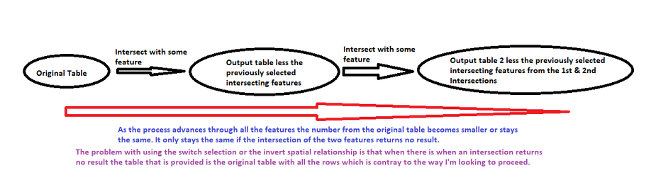

MPach
@MehdiPira1 I'm not actually sure that solution works, but I haven't tested it yet. I think the suggested solution that you recommended might have the same flaw as the one that I first tried. That flaw being if there is no intersection of the features the table selection that will be returned would be the entire contents of the original table.
I sketched up a quick drawing of the flow to get to the solution. I hope it's legible.
I think the solution involves using a test case (If...Then....Else workflow) to see if the row count of the intersection is = 0 and then if that occurs I use the previous tables selection in the next part of my workflow. Doing that I should still be proceeding in the right direction instead of starting over with the original data table.
