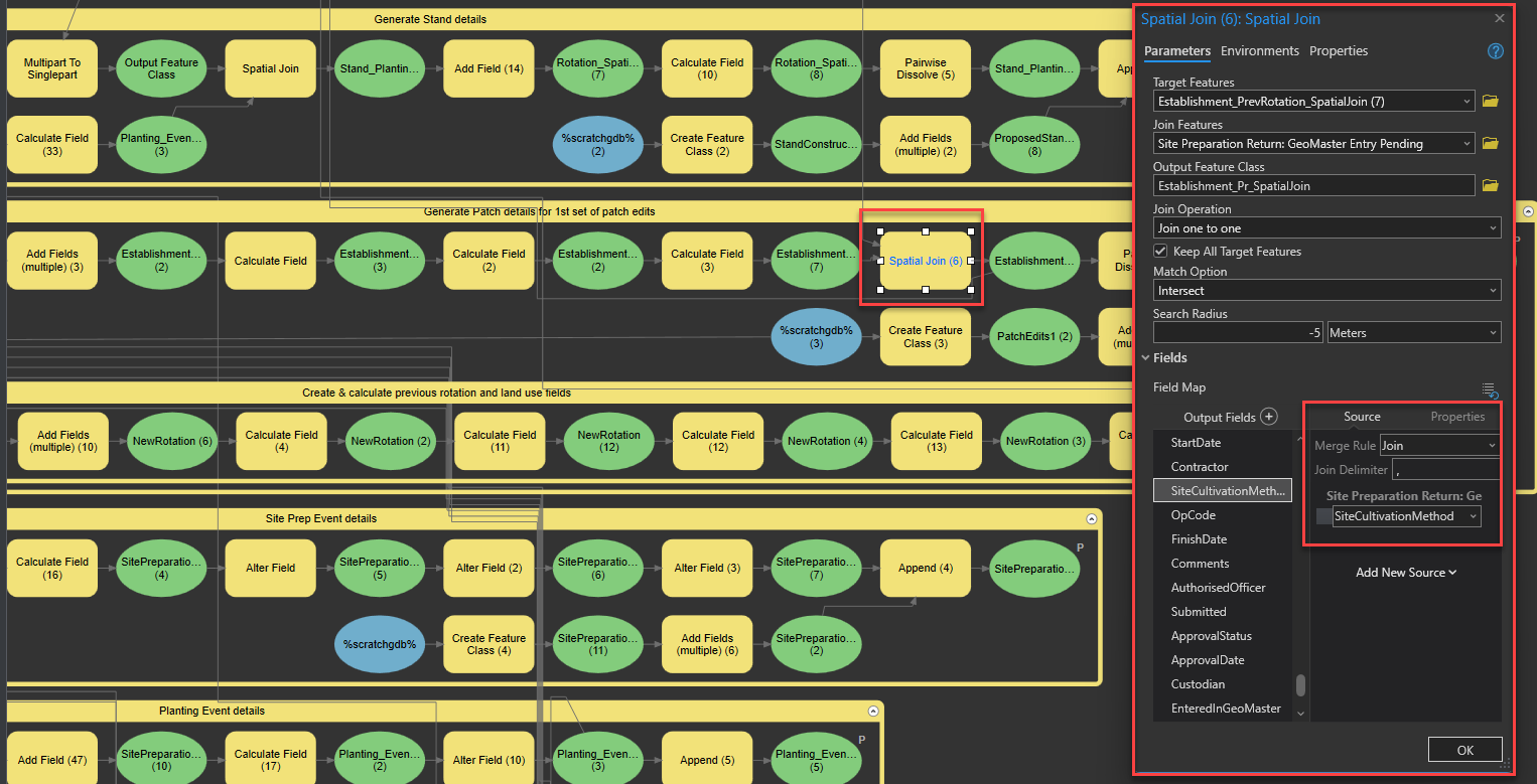

I have built a model in model  builder that does a heap of data intersecting, spatial joins and dissolves to produce a number of layers which are used to streamline a complex data entry process. I'm having issues with one tool which I'm out of ideas for.

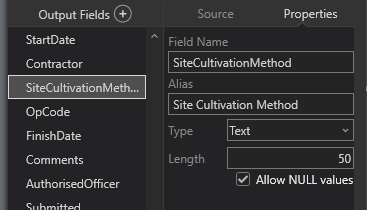

In one of my Spatial Joins, I have a field map customised to use the "Join" option with ", " set as the delimter so that all intersected values for that field are concatenated. See the screenshot below.

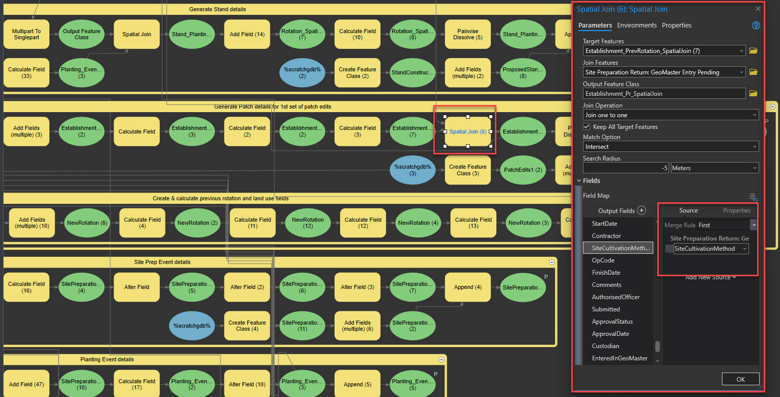

However, when a different user runs or edits the tool, the property defaults back to "First". If they update it to the Join option and save the model, when I open it, I now see the default "First" setting.

In the scenario I'm finding now though, I don't have those field length issues (only 50 characters). Can anyone suggest other things I need to look at?
