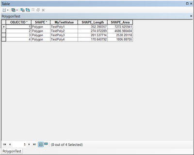

1) I added MyTestValue in PolygonTest to be the unique identifier of the polygon.  I am assuming each of your grid cells has a unique ID other than the ObjectID.  This is the equivalent of that in the test data.
2) That would be the case in my data if I had added two more polygons.  Your data should already have a unique ID assigned to each cell (that is not the ObjectID).
3) ObjectID is a unique Identifier, but Object IDs are not stable and can change when you run analysis (especially analysis that edits or changes the original data) or edit data.  Its better to use a stable, user defined, unique ID (like MyTestValue in this case).

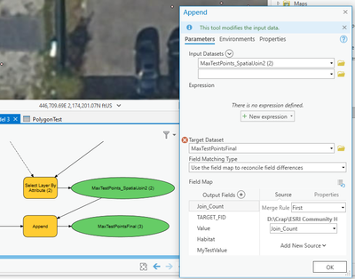

4) Here it is.  The append tool takes another feature layer as a "Target".  I created this as an empty Feature Class to accept the output of the append.  I simply created a point Feature Class with columns to accept the values I needed.
5) "(2)" and "(3)" show the same dataset after it has been acted on by a different tool.  (3) contains the set of records selected by the first Select by Attribute and (2) contains the set of selected records after the second.
The data I used is simply the 13 points in the original post's image and 2 polygons those points fall within.  I created the data in a few minutes just to test the model.

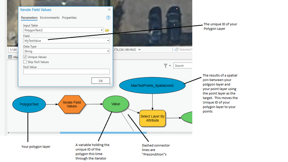

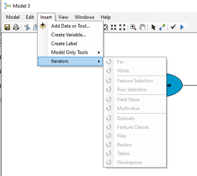

Using the images of the model I created you can create your own model using Model Builder in ArcMap, but customized to user your own data.  The images were meant to provide a blue print and the model is not really "plug and play".

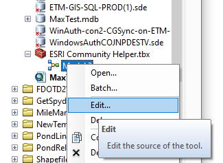

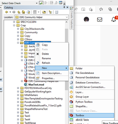

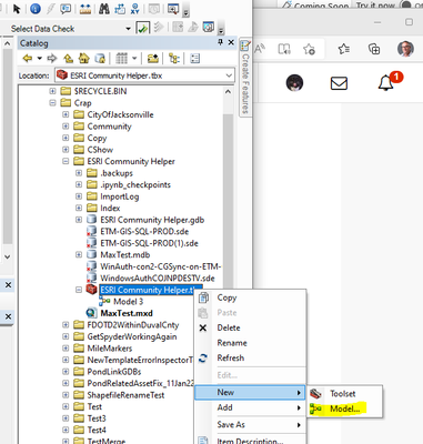

You create a model in a tool box you create:
In that tool box you create a new model and edit it:

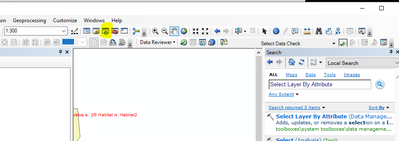

The names of the tool in the model (for example "Select by Attribute") can be dragged into the model from the "Search" dialog:
The iterator can be added like this:
The code I sent for the tools will have to be customized for your data.

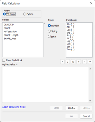

If I want generate the value for the field MyTestValue I would like to use
the Field Calculator from Table:
How can write a script that make a union of a text "TestPoly" and the value of ObjectID or progressive numeber ?
TestPoly4
TestPoly5
TestPoly495054

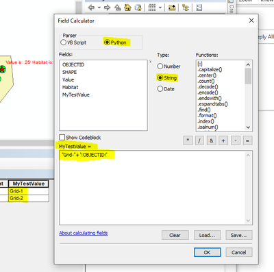

If your Grid Cells do not already have a unique ID other than Object ID I would give them one.
Backup all of your feature classes first and work on copies of those.
Then add a column to your Grid Cells polygon FC called something like GridID (String, 25 length).  This will be the equivalent to where I use "MyTestValue".
Use Field Calculator to calculate that field equal to the word "GRID-" with a cell number after it.  That will give them each an "unchangeable" ID.... ("Grid-1','Grid-2',.....'Grid-500000')
You have to use the "Python" and "String" options (highlighted)
"Grid-"+ '!OBJECTID!'
This will give you a Grid cell feature class (I'm going to call it "GridCellPolys" here for reference) with a unique ID.  That maps to "PolygonTest" in my model.

Hello Kim.
Can you expalin two things:
1) Select Layer by attribute and  Select by attribute are the same ? If no why you use the first ?
2) In the query: Value = (SELECT MAX(Value) FROM MaxTestPoints_SpatialJoin2 WHERE MyTestValue = '%Value%') why there is '%Value%' and not only Value ?
KimberlyGarbade
1) Its a little confusing, but the the first select by attribute selects all points in the HabitatPnts_SJ_GridPolys that have the same value for area as the highest value in the Grid cell you are processing.  For instance if the current Grid cell being processed is Grid-25 and the maximum habitat area with this cell is 50 hectares, the first query selects all records in the  HabitatPnts_SJ_GridPolys feature class with an Area of 50.  That selection set includes the one (or more) points you are interested in returning, plus all other points with an Area of 50.  The second select by attribute excludes all points not in Grid-25; leaving you with just the points you want (I.E. those points (one or more) that represent the highest habitat by area in that grid cell).

2) %Value% is a variable in the model.  It is set each time the iterator loops.  It is the unique identifier of the polygon you are processing this time through the iterator.  It is vital that this be set correctly as the "Field" property of the iterator.
