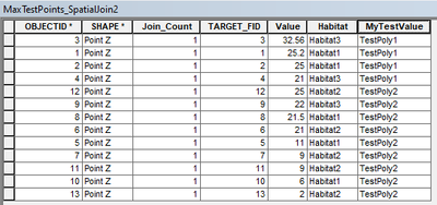

Using these two I did a spatial joint using points as the target to move the MyTestValue into the points.  The result I called MaxTestPoints_SpatialJoin2

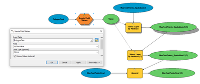

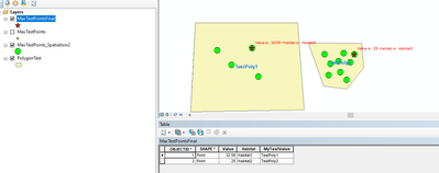

Then I created a model that pulls just one point for each polygon from this feature class and appends it into a new feature class I called "MaxTestPointsFinal".  Each point in MaxTestPointsFinal is the point representing the Maximum value for a MyTestValue polygon.... confusing I know, but when you see the output below I think it will make more sense.

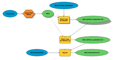

The model is pretty simple.  The top image is just the model.  The images that follow that show important details about the steps:
Iterator on polygon layer, value is the unique ID of the polygon

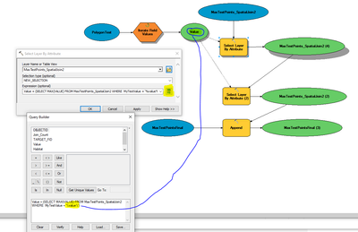

Select by attribute (gets all records that share max value)

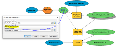

Select by Attribute (with Remove_From_Selection option) to exclude all points that do not fall within the polygon being considered.
The append step just appends the identified point to a feature class of all Max value points.
