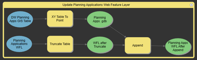

JamesShreeve
Hi, after a while I managed to find an alternative message which didn't involve have much more Python knowledge than I currently have. I used ModelBuilder to create a tool which truncates and re-populates the web feature layer, once I had the model created I then scheduled it using the function within ArcGIS Pro. I've had this running quite a few months now with no issues. The only caveat I would say is that the data I'm dealing with allows me to just truncate and append. I've added a screenshot below of how my tool is set-up, this tool converts a database table into points and then truncates the web feature layer then appends the created points to the WFL. Hopefully this is of some help to you and please feel free to ask any questions. Thanks!
